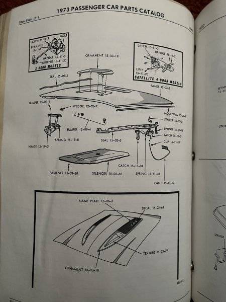

Hey bud, I am looking for a good 74 hood. Might you want to let one of your hoods go?We have a 73 roadrunner, and a second hood off a 74. 73 has hood vents and the 74 has none. Our 73 has 3 point seat belt harness, I thought all cars did in 73? Hard to see the hood vents in any of the pictures posted. Bumper guards would be a better way. I think the 74 plasticbumper guards look like the pictures posted, so I am going to say that car was a 74...

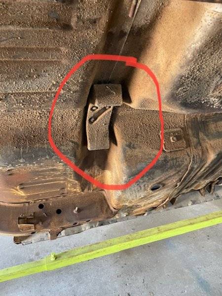

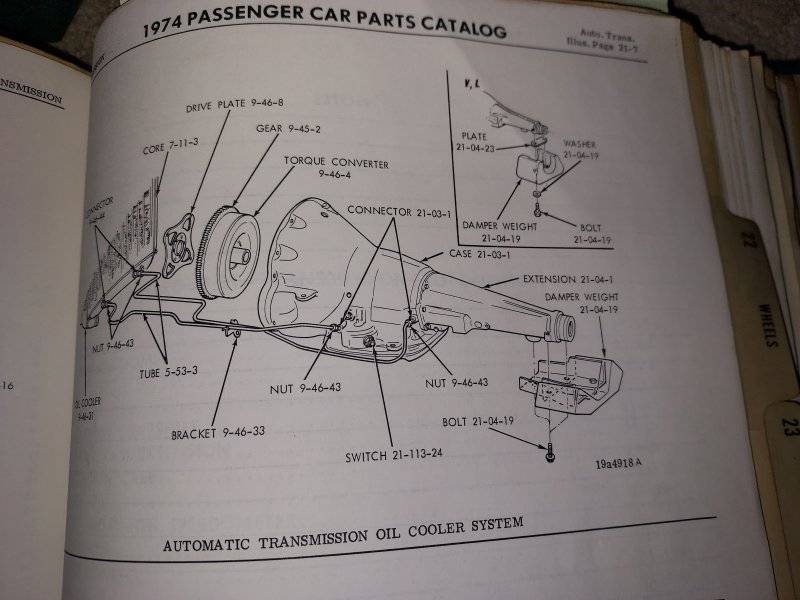

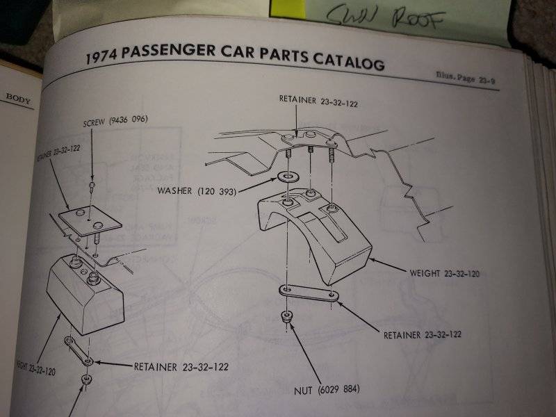

and added more info71-3 had the tunnel weight. 74 had the weight on the tranny tail housing.

My 74 got the tunnel weight. Also ilustrated on PM.71-3 had the tunnel weight. 74 had the weight on the tranny tail housing.
i think imposible to know it. Venezuelan assembled cars don’t have date codes like in USA, at least that we are aware of.My Coronet was a Dec built car and has the tranny weight. When was your car built Nacho?
