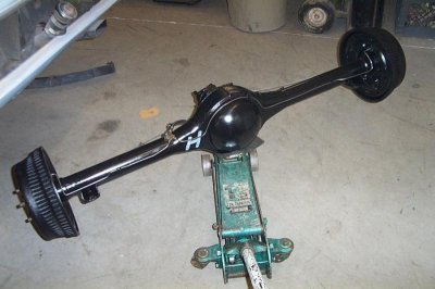

Fuel pump went out on the Dakota today so I didn't make it to the yard. Here are the brakes that I have.
Post a close up pic of the inside of your backing plates should know by that
Well I'm over my brian fart now. Yes those are 11x2.5, duh. Was looking at the wrong B/P. My pile of brakes is a mess. Really need to go through it. Have a stack of the drums but didn't find the B/P yet. Ran out of daylight so will hit it again tomorrow afternoon.
