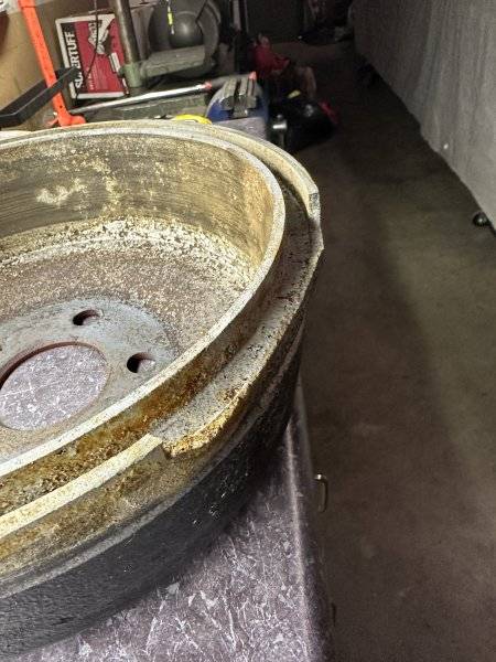

Need one 11x3 Drum for my 69 Super Bee right front. Mine is damaged per pic.
You sure that is a 3" ? Picture might be deceiving. The pads measure 3" wide?
Are you looking for new or used? The one in the picture looks aftermarket so easier to find.
And not the greatest quality, but you can get new ones pretty easily. Here is one on Rock Auto. I have some on the shelf that I bought new some years ago and turned them to get them true.

Thank you. So I should measure the pad width to verify?
Also I was unaware this is aftermarket, sure appears to have been on here a while.

Yes - measure pad width to make sure its 3". It probably is. It looks aftermarket to me, but I can't swear 100%. Aftermarket in my experience are thicker at the flange. Was it swaged on? If not, its aftermarket.

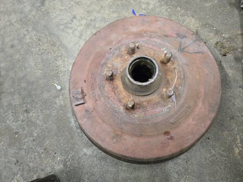

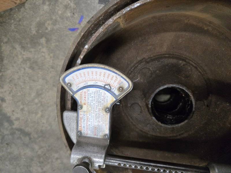

I have a right hand thread stud, factory drum assy. Just pulled it off the backing plate, so while its dirty, you can see the lining surface where the shoe protected it.
It is currently .040" oversize.
While a new offshore drum is only $51 from rockauto, you have to factor in finding studs, and finding someone to swedge it together. Mine is available for $40 and shipping. Dirt is free.

You were correct. Pad width is 2.5” So I need 11 x 2.5 drum? or is it correct to call it 11x3 based on the actual depth, not just the pad wear area? Thanks
My drum, according to those herein appears to be aftermarket. The drum slid right off the hub just like lots of other cars. I was unaware they need to be fastened together or “swedge” together. How and why would they be necessary? Also my drum measure a bit over 3” in depth, the diameter is 11”. I
Measured the actual pads today and they are 2 1/2 “. Perhaps I need educating on all this?

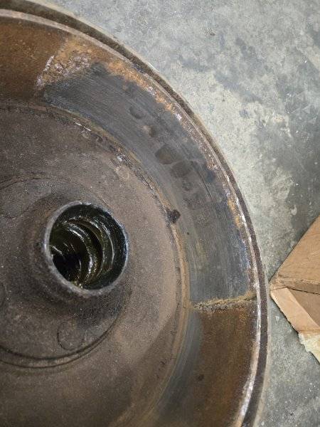

The drums are definitely 11 x 3. I believe someone used the 2 1/2 pads. Also I may be wrong but it appears the drums are original as there is red paint behind the black, could be wrong.
The rear is pictured and finned but I have not removed it yet or measured.
Anyway it is one of these that is broken on the other side and I need a replacement. Also need to purchase the correct shoes….

The swedging of the drum is to avoid the
elliptical nature of a drum not bound to the hub.
It's not much of a variable, how much clearance does a drum have sliding onto a hub?
Maybe 010" out of round?
