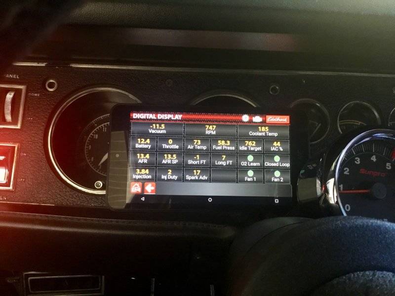

If not for efi readout, would not be aware. No other symptoms. Should be 13 or 14 right? The dime store power master is about 15 years old. What output and brand is recommended? Battery is ancient too. Is it struggling to charge a bad battery?

Have each tested. Only way to really know for sure. Batteries these days are lucky to last 3-4 years
Battery life is a crap shoot. My original 05 Ram battery just quit after 14 years and 3 months. My SRT 2010 battery just quit after 81/2 years. When ever I start them I always run them enough to make sure Batt. is fully charged. The SRT I always hooked up a battery tender when not in use, so surprised it quit after 8 years. Although with the higher compression of the 6.1 vs the 5.7 was probably another factor.
Thanks. Orginal battery in 09 Challenger lights right up and lays a lot. I don’t give up easy.
Hi,
I agree, today's generic batteries tend to work and then fail with very little warning. But even with a weak battery you should see 13-14 vdc when the engine is running. Definitely test the system before you replace anything.
This is where having an Ammeter is helpful, but not necessary.. Voltage and Amps, in a good working system slide in opposite directions when working correctly. High Amperage, lower voltage. Lower Amperage, higher Voltage. But, it should not read less then 12.6
Take a meter and go across the battery terminals and measure. Your readout circuit location is unknown.
If he has that large of a Voltage drop from where the EFI is connected (Ate the Battery if they follow the directions) to the battery, he would have bigger problems.
I always start with cleaning the terminals and making sure everything is tight and clean.
The last 3 batteries I've owned have lasted over 8 years each, of which I'm extremely happy about! The average lifespan of a battery is 4 years, anything after that and your living on borrowed battery. I live by this rule!
You could throw parts at it all day and maybe fix the problem. You need to do a complete battery/charging system test to start with.

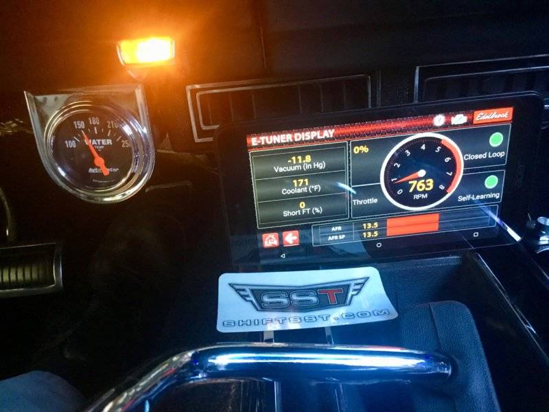

I’ll check connections first. There is a large plug receiver new to the battery area since efi. Also put a high power Receiver in recently. I trickle it on occasion. On the subject of variations, the coolant read 151 on the aftermarket gauge and 171 on the Edelbrock tablet at the same time. Different take off points? Suffering from TMI these days.
Can be,if the 2 sensors are in different locations. Using a laser temp gun I've checked temps in several different places of a running engine. Such as thermostat housing, top of rad, bottom hose connection, front of head core plug and block core plug. The temps vary as much as 20* or more.
Also new sensor vs old.. I had two coolant gauges and dropped both sensors into boiling water and they were both off, both around 10 degrees lower..
To bad you are not closer, we could use my Sun VAT60 and Snap-on scope to check the Alt wave form. There is a way to full field the alt to check for Max output, just dont do it for to long though or you will let the smoke out.
could just be a bad voltage regulator. full field it that will tell you if its the alt or regulator. down in phoenix 2 yrs max on batteries the heat just does them in. you might think about going one size larger on batt cables and main alt wire with the new efi stuff. just a thought
Took a DMM and made some measurements. Cold battery measured 12.6V. Started car and measured 15.2, then 14.8, then 14.2V.
Hot idle headlights on, AC, radio measured 13.2 at battery.
The EFI tablet always measured 0.4 to 0.6 lower than the DMM.
Probed a few spots under the hood. Difference from battery was never higher than 0.3V.
I’m calling it good for now. Thanks Billccm.
What was ouput off the alt charge stud with all the accessories live?
Ground it back to the battery neg when testing.
