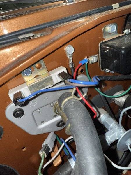

Hello!
So today Ive noticed that I have lower battery charging voltage (13.8) than alternator voltage output (14.5).
When on idle, battery voltage sometimes drop to 12.9 (not sure what was on alt output at this time)
Also my amp meter is sometimes show value below 0, and my interior lights pulses a bit when on idle or reving engine.

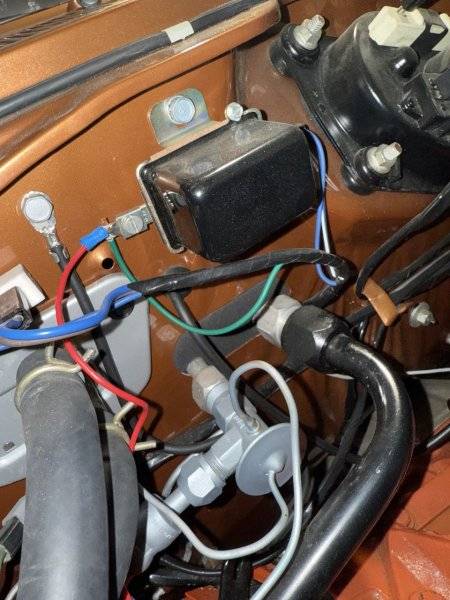

Should I check VR first? I have mechanical style.
Notice for VR photo - I have electric choke connected to field port of VR - should I switch it to balast output? I disconnected electric choke today but this do not increased battery voltage while charging.
I would be very suspicious of the choke power lead connected to the field side of your regulator. I would switch it to the 12.8 volt side of the ballast. It might be your problem and it might not.

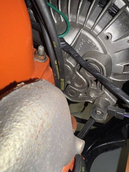

I also wanted to make full field test - but I'm not sure if I should connect field from alt to ground of battery (-) or field from alt to output of alt (+).
Get that wire off the regulator. Find a proper 12 volt key on source.
The regulator Field only goes to the alternator, nothing else. A search or list of Similar Threads below should have more info on charging related issues.
