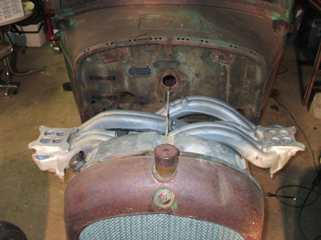

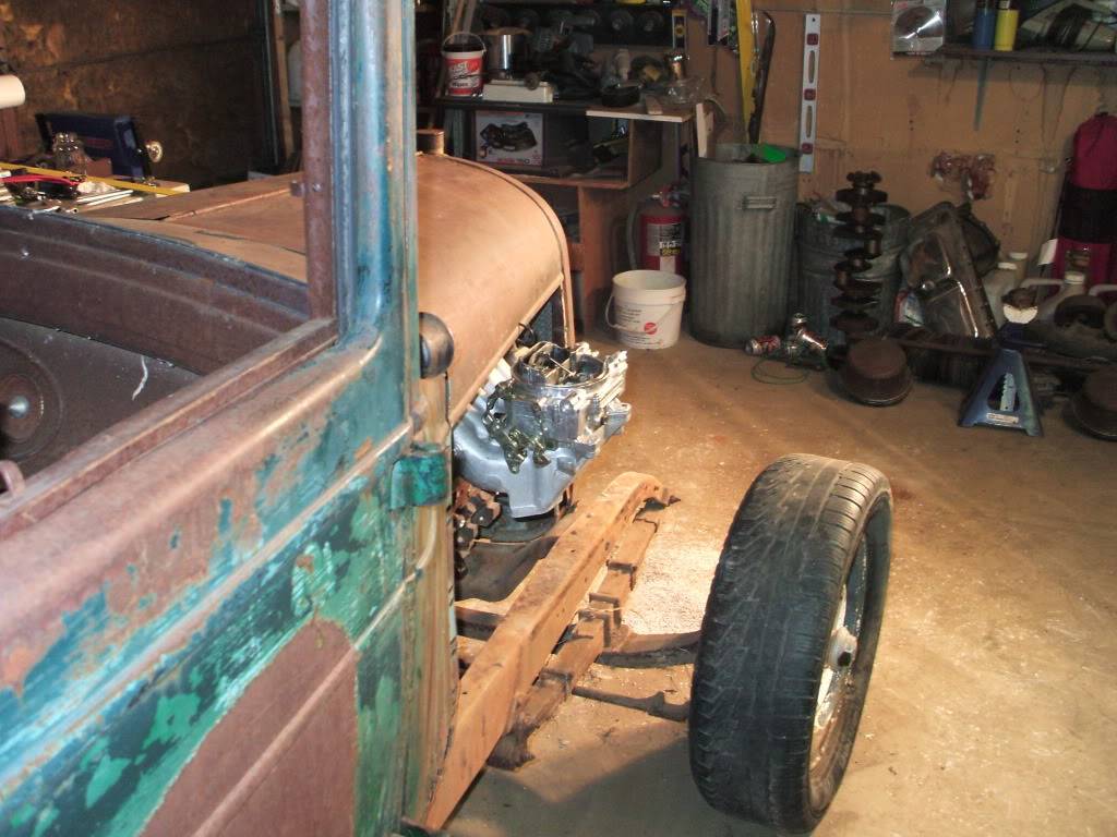

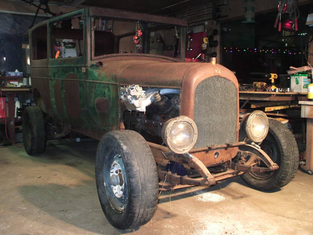

Hello to everyone. I am new to the site, but I am looking forward to being a part of the Mopar community. I am just starting my 1928 Chrysler project (Still in the measuring and planning stages) but I have posted a few pictures of it with the 440 and Long Ram intake set in place. Thanks for having me and I hope to learn lots.

My main goal is to keep it all Mopar. I'm having the engine stroked to 500 and built to put out around 500hp & 580lb/ft of torque & mating that to a 727 tranny. The frame will be boxed & reinforced to handle the weight & torque. I'm going to put a 6" drop tube axle in the front, but I'm gonna stick with the parallel leafs to be original & mount them under the axle to lower it down - everyone always switches these out to a Ford style Transverse leaf setup. In rear I am going to run an 8 3/4 diff with a 4 bar setup & coilovers. Disc brakes front & rear. It will get a 4" chop but I am not going to channel the body in case I want to put the fenders back on it down the road. The rest I'll make up as I go along.
