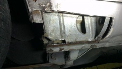

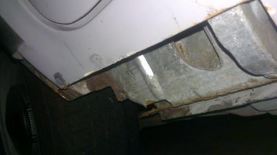

I own a 62 Phoenix (Polara/Dart 440 in USA) and discovered some rust in RH rear Rocker Panel. Common place to rust I hear.
Has anyone repaired this area? I can't seem to find any rocker panels for 62's online.
I have removed all the rust and now need to weld in new steel. See photo below.
I got quoted $1400 (US = about the same) to get it repaired and painted. I am willing to start trying to fabricate the metal myself.
I do everything myself on car and am good with my hands.
I have access to a MIG welder and want to start giving it a shot.
I am finding it hard to find any repairs similar to this on this forum.
Can someone point me in right direction what to do.
Is it a big job?

Now that ya got the rust cut out, start fabbing up some patches and burn them in. Take your time, space your tack welds, and have some fun.

As 5.7 said, you don't really need specifically made repair panels for this. Using similar thickness sheet steel you can shape and tack it in easy peasy. This is an excellent project to cut your teeth on body repair. MIGs are a god send...

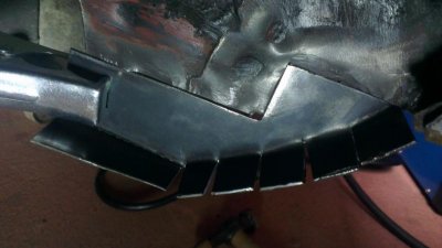

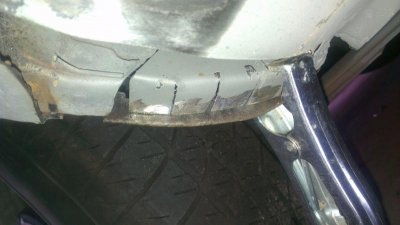

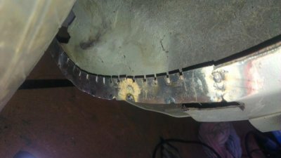

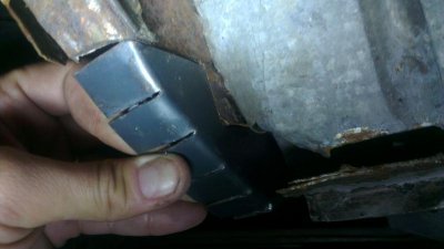

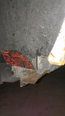

i have made some progress.
I have made the first of the patch panels.
I will be "butt welding" this from the outside (where it is red) and will be tacking it in for now.
WIll have it all nice and clean and scuffed back to bare metal.
any comments or thoughts?
My brother has a mig welder so i will try tack this in on the weekend I'm taking it nice and slow.
Will practice on the scrap of i have got to make sure i can make a nice clean join.
I think it is a gasless welder. Not sure. If so I have read on here it is harder to weld???
George

If it is gassless then it uses flux core wire. Normally the weld isn't quite as clean but with some practice I don't think it will be a problem.

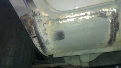

I bought myself a 150 Amp CIGWELD MIG Welder. It welds both gas/gas less. I did all this with 0.8mm flux core wire. Just nice and slow. Blew a few holes here and there but am happy with the results. I put fibreglass filler on welded area to fill in the gaps between tacks. Then bondo to finish off.
What do you all think?
