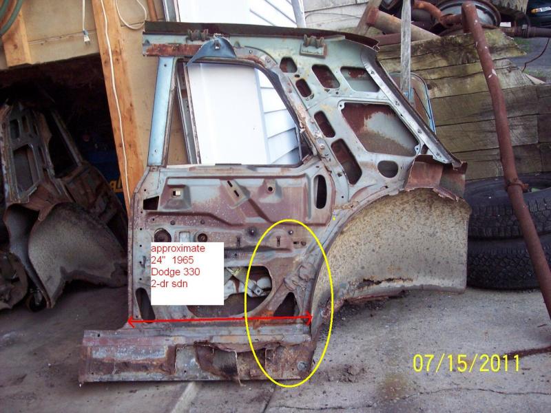

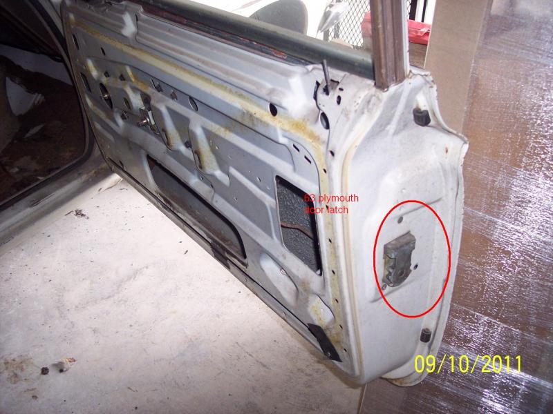

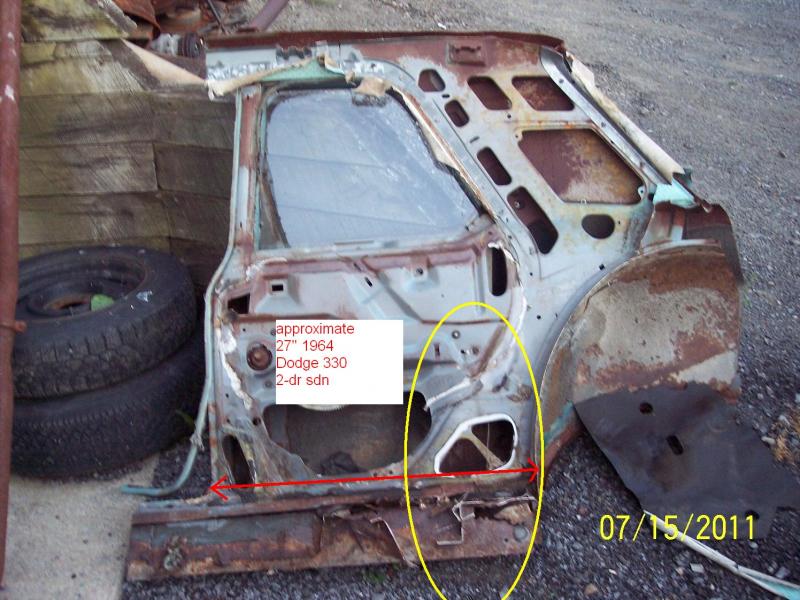

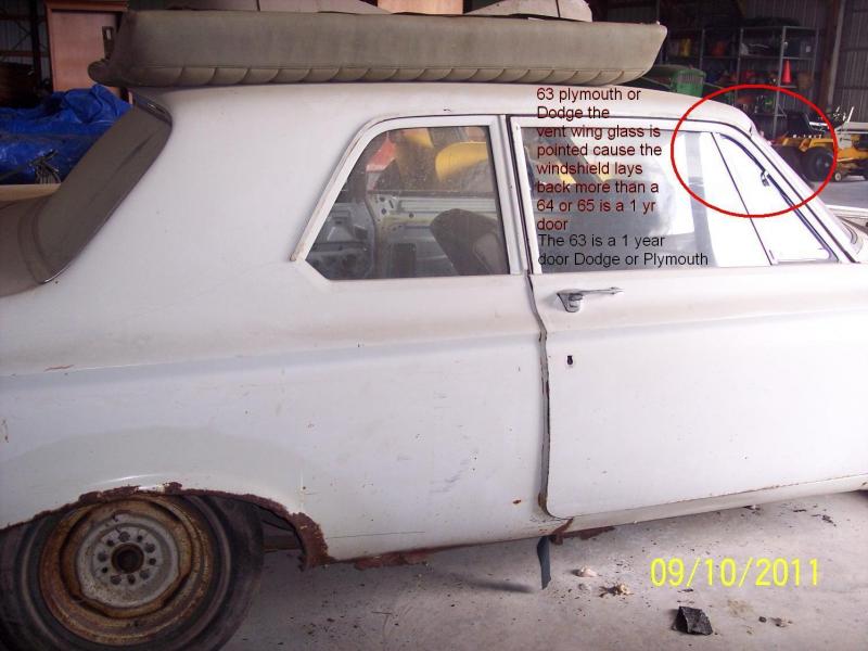

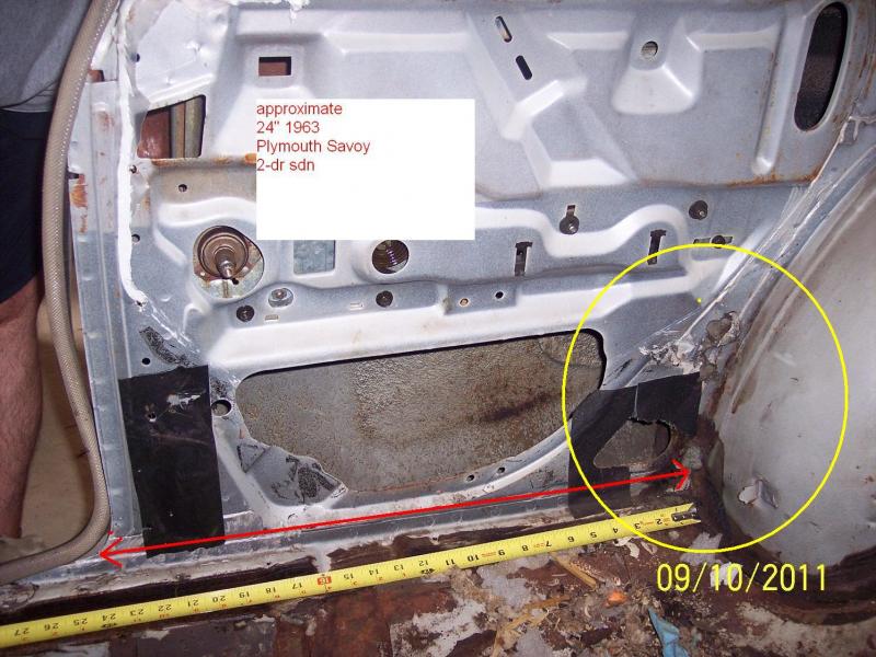

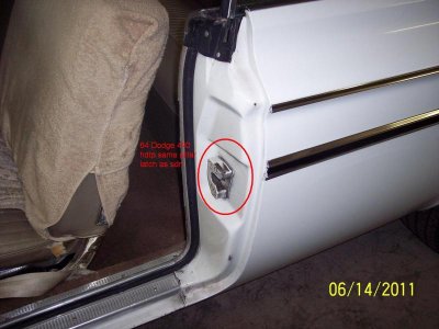

The 63 2- dr sdn doors are a 1 year door (Dodge and Plymouth)
The 64 -65 2- dr sdn doors are the same ( Dodge or Plymouth)
You can convert 2-dr hdtp doors if you are skilled from the 4 dr sdn door frames.
The 2- dr sdn door glass 63-65 is the same.
The quarter glass 63-65 is the same.
The vent glass 63 are the same.
The vent glass 64-65 are the same.

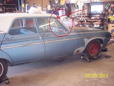

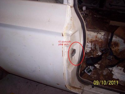

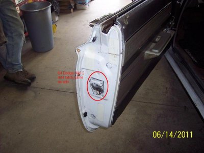

Here are some pictures that you can see the differences in the latches,
vents,and where the difference in the wheelbase is make up.I am going
to do a 64 Belvedere 4 door to 2 door conversion,so I have been taking
alot of pictures and doing research on the differences.
Jeff
