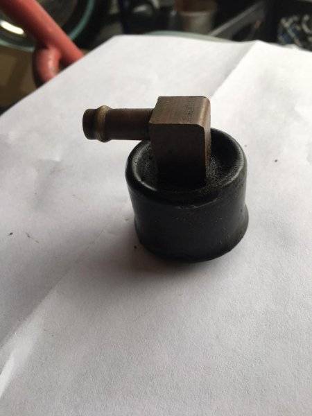

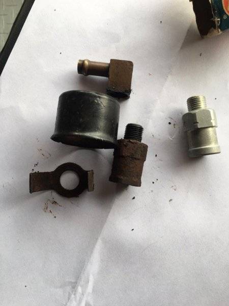

My low miles '63 Polara 318 has, what I believe is the original PCV setup. Thought that I would share the pics of the original, taken apart, cleaned, new valve, painted, and assembled. I know that it appears different than others but based on everything, I do believe that this is correct for the application.
That is exactly what my '65 looked like. My '63 with the brass/bronze 90* fitting, sure doesn't look like it has ever been changed before. The listing for the AC PCV valve shows early MoPar 6 and 8 cylinder. I am no expert by a long shot. Just posted in case it will help someone.
If I remember that far way back, I believe the one Big Bill shows was basically what my 64 Sport Fury. But for 63 I don’t know.
