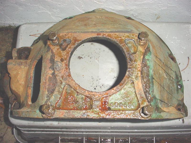

You have an interesting car, the sort that most people dont get into, but I do. The bellhousing was different between 3 and 4 speeds. The housing you will want, to keep the 3 speed is casting 2402683. The 1965 number for same deal , 3 spd, is 2468450. They are not common, only because so many got pitched in favor of 4 spd conversion. If it were any other car, not the police, I'd convert to a 4 speed in a minute. Getting a trans will take some waiting but Im sure one is floating around out there. Perhaps keep your options open by acquiring a 4 speed set up if the deal comes around. The engine will be available out of some C body, newport or 880 car.

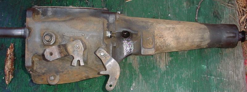

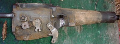

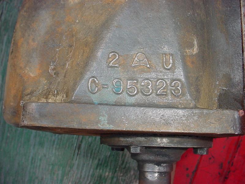

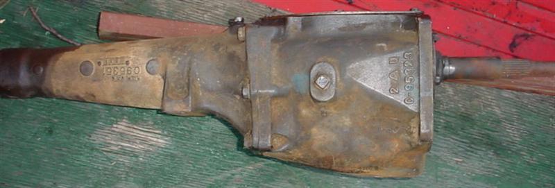

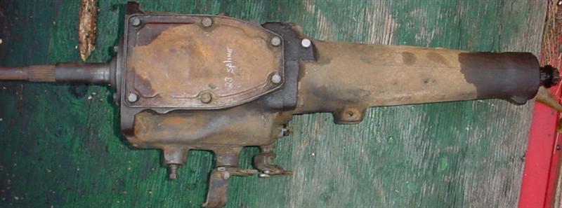

Hello. I just joined the site and saw your post about 64/65 big block 3 speed cars.
I recently aquired a A-745 trans and bellhousing, (2468450-65 361/383 3-speed w/10 1/2" clutch). The trans is listed as HD police and taxi w/big block.
The trans has a splined output shaft with a bolt on flange.
If this is what you need I will let both go for $275.00.
Will.... bluefury361@yahoo.com...256-214-2792. In Alabama.
