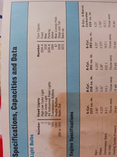

Quick headlight question. Looking for a new set of low beams for my Fury, due to a burnout. I am going for a stock restoration. Nothing fancy I just want to pick out the right bulbs that are going to be electrically the same the stock ones. I am not interested in vintage $$$ ones.
I included a photo from the car's manual for reference. Thanks y'all!
Would any of these work?
1964 Plymouth Fury Headlight Bulb - Philips H5006C1
Philips 4000C1 Headlight Bulb
4002 upgrade sealed beam lamp, 12V, 2-pack - 4002-2
Yes, all three will work, but the H5006 ( H for Halogan ) are definitely 33 % brighter...
Get them....
Get them....
Will any of them impact my electrical system? For example drawing more current then the stock light and thereby warming wiring, draining battery, or dimming other components. Apologies if that is a noob question, but I am just learning and do not want to do damage.
Thanks again!
