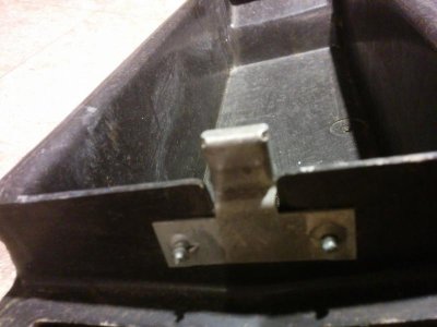

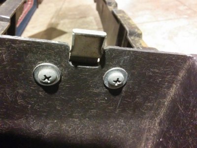

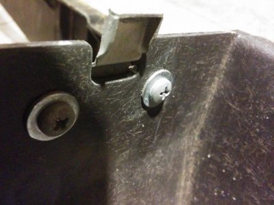

Glad to see you got bulb installed. I have a question for you.
Bought a used console for my 65 Coronet and the latch plate that holds the lid closed is missing. Any idea of what it looks like?
A picture would be great and then maybe I can just make one.

I will try to remember to take a picture of it tonight. I'm at work right now, so if you don't see something in a couple of days hit me up again.
