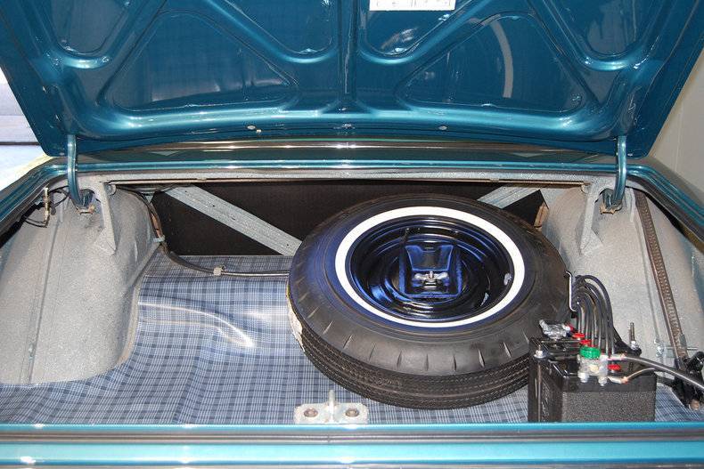

we used Zolatone on a friends car, but it had to be sprayed out of a gun (see the picture how it turned out) pretty close to the factory spatter
