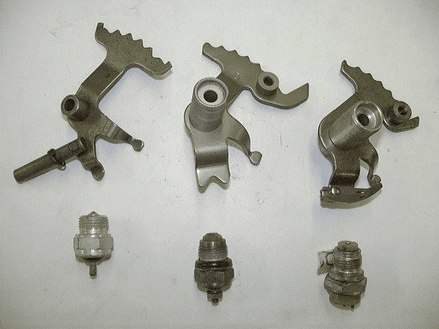

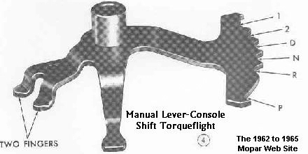

Do you have a push button valve body? Or is is a floor shift 64/column shift 65 valve body? The rooster comb, manual valve, and nuetral switch are different between the two types. The wrong valve body can be easily convertered by swapping the correct rooster comb, manual valve. neutral safety switch. I'd pull the pan and watch what is happening. The parts on the left are correct. The othe two parts are not cable shift, But the middle switch is correct for a flor/column cable shift. the lower picture is a 65 floor/column rooster comb.
