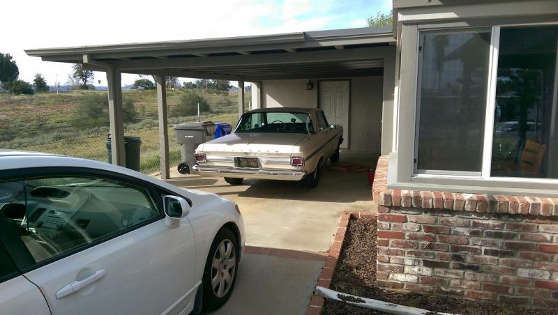

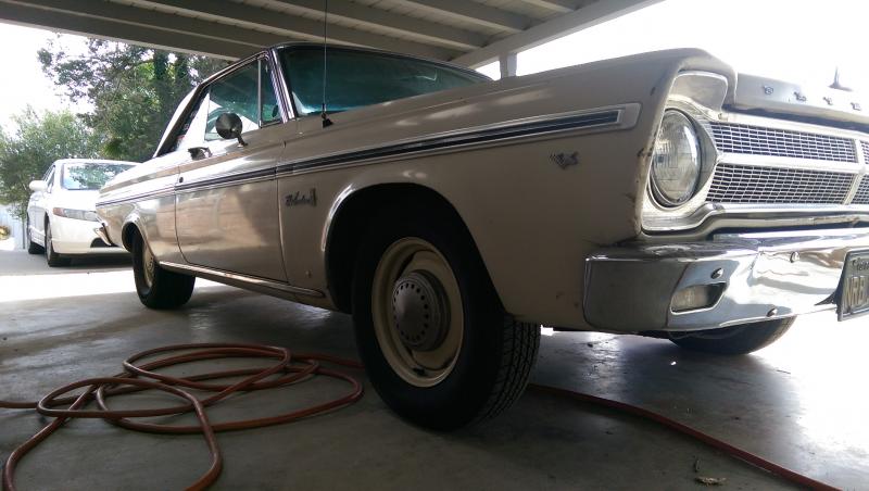

Hey guys, just picked up my first muscle car, a 65 belvedere. Can't afford to restore it, so I'll just be making improvements here and there with mostly used parts. Any advice is appreciated.
The 318 feels pretty tired. I picked up the car in LA and drove it back to San Diego without issue. But it didn't have much grunt either. I was able to cruise 70 on the freeway, but if I stepped on it from there it didn't do much. From what I've read I'd have to find later model heads to run a 4 barrel so I think I'm just gonna cruise the stock 2 barrel until I can find a different motor to drop in. I'd love to put a wedge motor in it, but I'm sure it'll be easier to find a used 440.

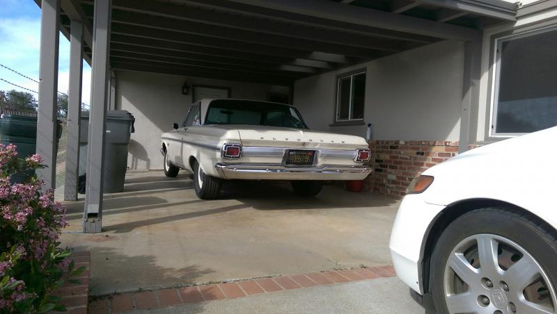

The other thing I'd like to address is the stance, it sits real low in the rear. I'd like to get the rear kicked up a bit so it looks more aggressive. Any suspension suggestions?
And there's a few rust spots, one good sized one on the hood. The rest appears to just be some surface rust here and there.
Well here's a few pics. Hope to hear back and I'll continue posting as I make upgrades.

A economical and "cheap" way to lift the rear for now is with Air Shocks
Nice find! Put a dual exhaust on it along with a four barrel and maybe change the rear gears to a lower 3:23 or even 3:55 sure grip for a little more get up and go! It might have a 3:23 open in it already! A pair of HD rear springs will give you a better stance! A cheap wheel change would be the 15"x7" cop wheels, you have the caps already. With a little digging you could probably do it all for around a $1000.00! GLW your new toy! Welcome to the group

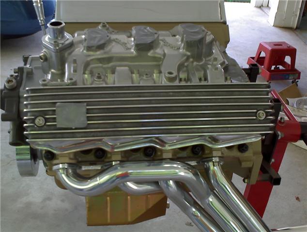

Original 318 poly
If you have to change heads to run a 4bbl carb you do not have a 318 but a 273, which would require a head change unless you found a 65 or 66 273 4bbl intake, not so with a Poly 318. If the valve covers are not shaped like mine at the bottom you have a weak *** 180hp 273, no wonder it has no juice!
It's the original 318 poly, all the aftermarket manufacturers make parts for the newer 318.

nice looking car. maybe raise the rear with shackles, and replace worn shocks with kyb's or similar. give it a good tune up for now. maybe later down the road pitch the points for pertronix or something like it. then just slowly accumulate performance goodies.
