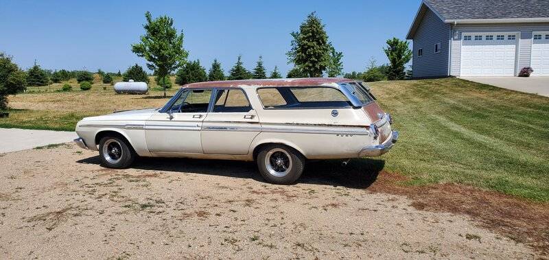

well, I ordered a set of Mopar springs from Jegs. XHD leaf springs, got them on the car today and the car now sits about 2" lower then the old factory springs that were sacked out. they are actually arched backwards at the rear. very frustrating to say the least. gonna have a set made by Eaton Detroit springs.
This how my 64 wagon sits after the new springs were installed.
