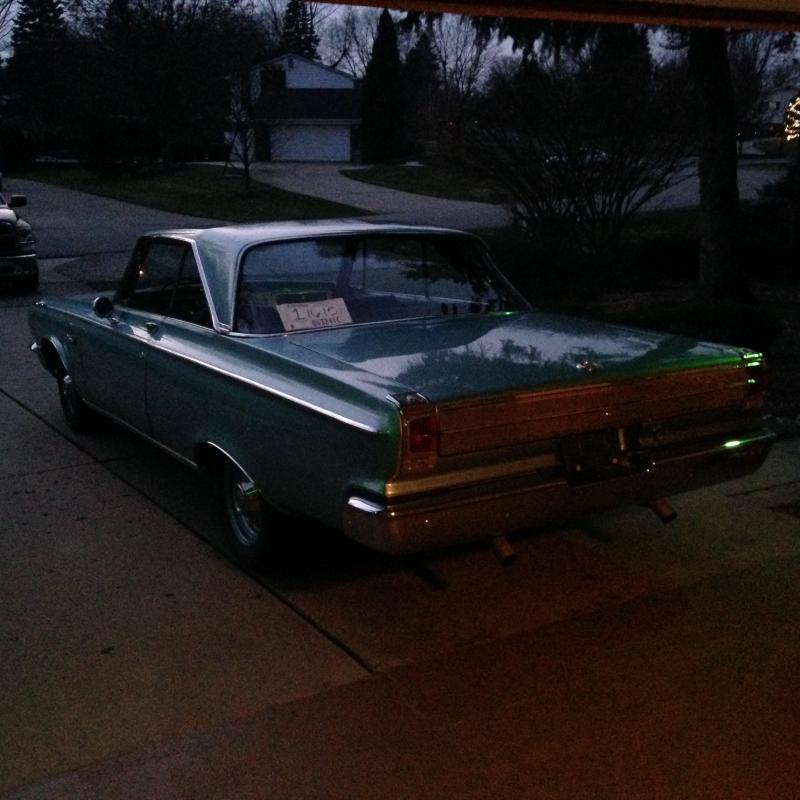

IMG_1422.jpgI am planning on converting by manual drum brakes to a power disc brake system. Currently front & rear drums and I think I want to convert only the fronts based on some of the thread comments I have read. I will be using the car mostly as a driver around town, etc. not a show car or drag car. I plan to use a "right stuff" kit and understand the spindles are currently on BO 6-8 weeks. Is there any unique plumbing/valving I should be aware of or any concerns/issuse with this plan based on any experiences any of you may have had?
I appreciate your input.
