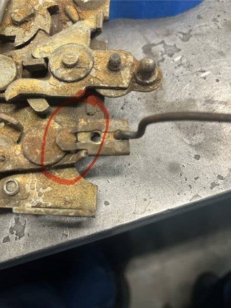

Morning folks, having one heck of a time trying to remove the door locks from either side of the car, can't seem to get the lock seperate from the rods inside the door. Any advice is welcome since I'm stuck at this point.
I think the rod comes out with the lock. slide the lower clip off.
I agree. Slide the clip out on the latch and pull the rod out out of the clip. Then take the lock out with the rod. You have to pull up on the tab on the clip. See the circled tab in my picture. This is from a 65 Fury. Your clip could be different.
