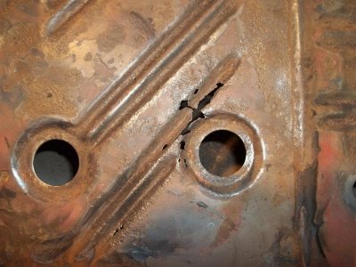

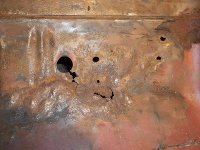

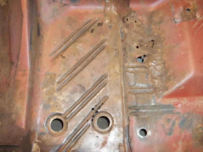

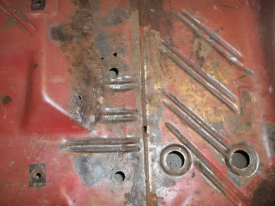

pulled up my carpet this week and found this. What do you recommend to do?
snow day 012.jpgsnow day 013.jpgsnow day 014.jpgsnow day 015.jpgsnow day 016.jpg
Sherman associates sells new pans for 65b bodies I replaced both front pans on my 65 satellite

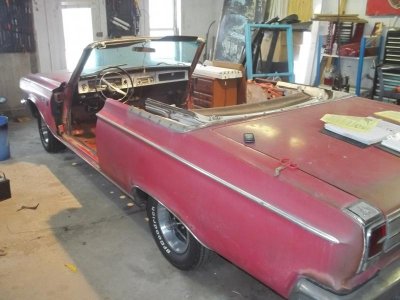

Still not bad, for a convert.
I would cut out bad and weld in my own pieces, seam seal around the patches, little paint.
have you looked at the cowl mine is in bad shape lets a little water in and did in the floors nice car i also have a 65-500-4 speed
