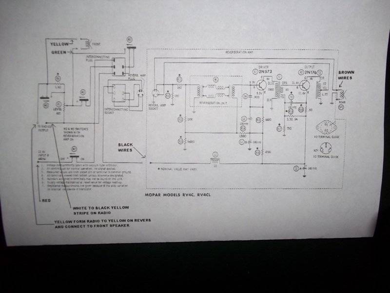

Does anyone know how to wire the stock Fury reverberator? A diagram would be great.
What year Fury?
I have a wiring diagram for a 1964 Polara if that would help.
I'll have to find it and post it for you.
Hopefully you will be able to read them. I have more somewhere, but cannot find them. I'll keep looking. Good luck with your reverb, they are very cool.

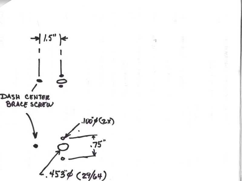

I kept my reverb and AM radio from my first Polara 500 (first car) in high school. I'm getting ready to install it into my current Polara 500 I purchased from my elderly uncle.

This is for my cousin's car, but he has the original harness and reverberator. Thanks anyway, and thanks again for the diagram
