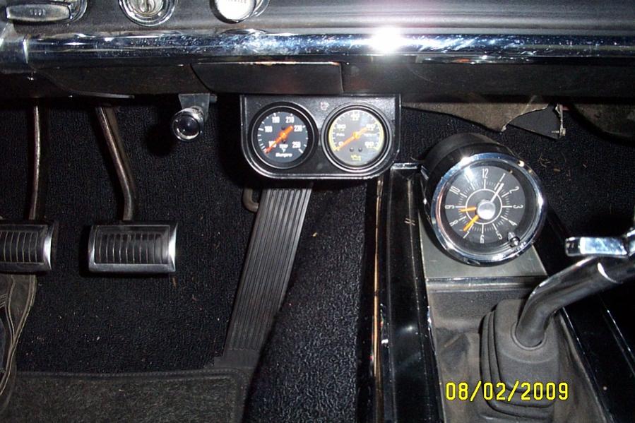

you need to be specific....what year you need? 66 & 67 are different. Our 66 is below

A383Wing, how are the '66 and '67 clocks different?
66 clocks light up the same as the instrument cluster...with the EL lighting......67 clocks lite up via 2 #57 bulbs....
you cannot plug in the wrong year clock....well, you can, but only if you don't want it to light up
