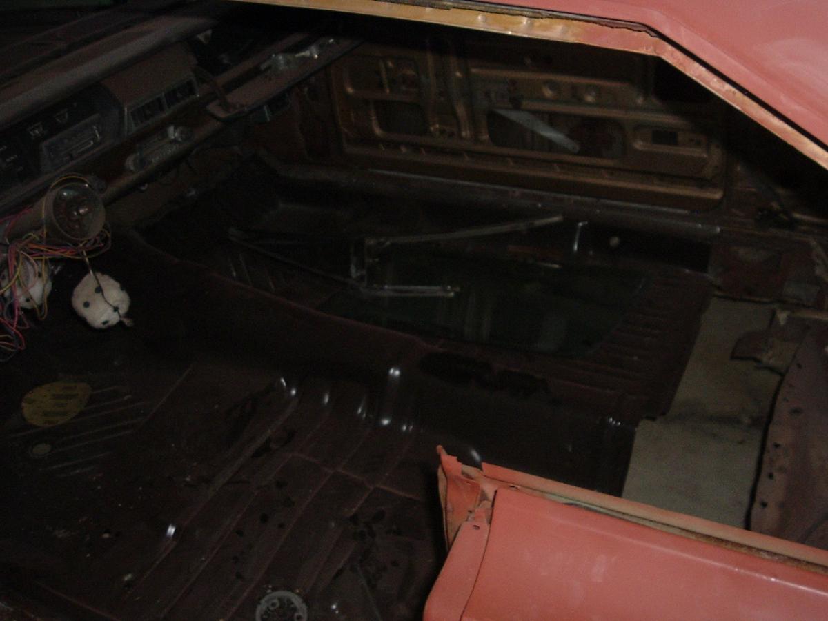

The tunnel sits really high in the center at the very front, it didn't have inboard braces for bucket seats, and probably the most obvious, it has the 68-70 flat spot on the tunnel for the auto shifter linkage, which the 66-67 doesn't have.
None are deal killers, though. Especially for a driver.
Hard to see, but look to the right and down from the fuzzy dice.

He did it, but there was lots of cursing.
He cheated on some of the areas near the wheel wells and above the frame horns, where he just couldn't get a drill or grinder. The metal was good, so he cut straight, cut the new pan to match, and butt welded, rather than using the factory seams.
I suggested cutting "pie shaped" wedges from the tunnel and closing them up to shrink it, but I think he's not going to worry that much since it is a console car.
