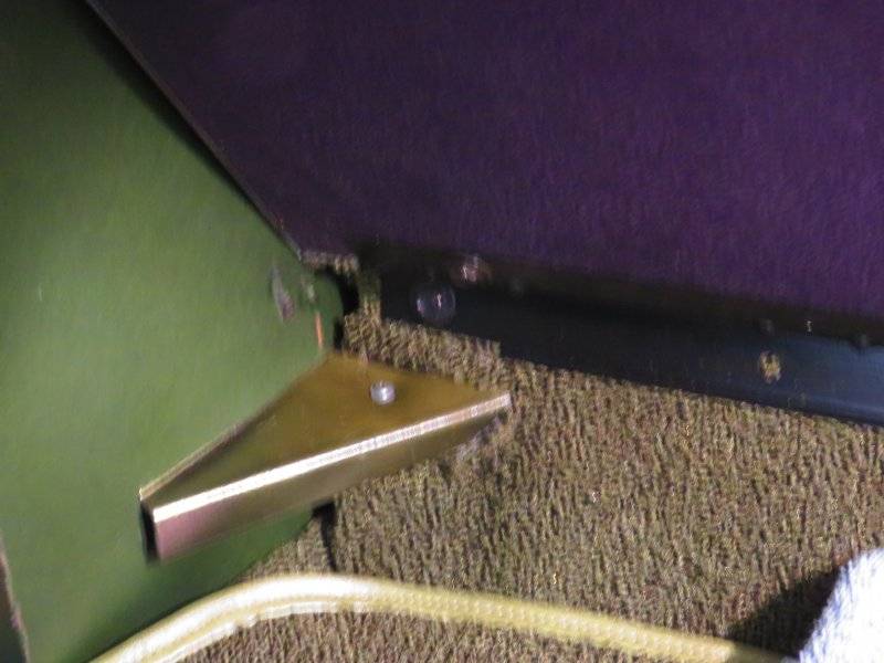

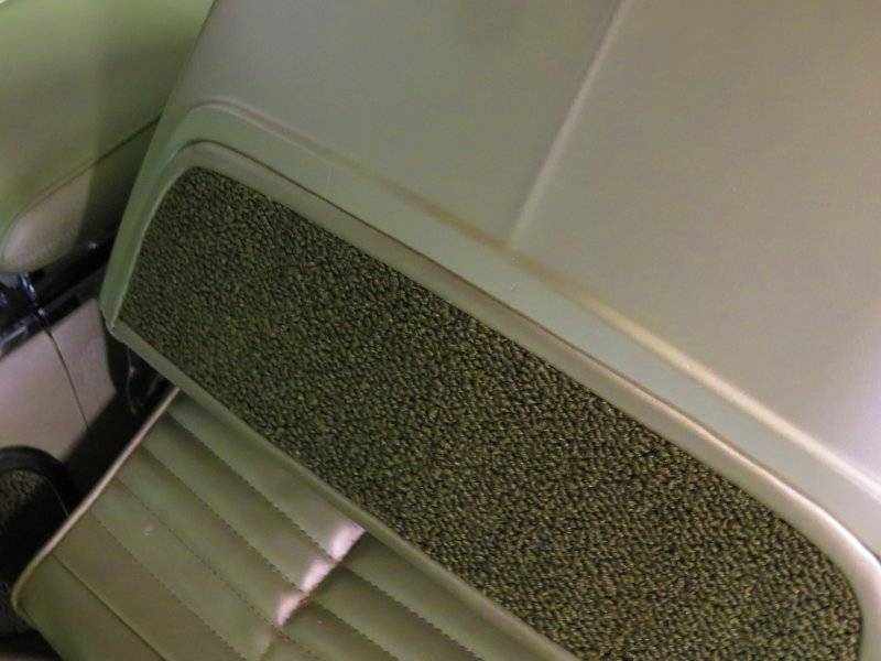

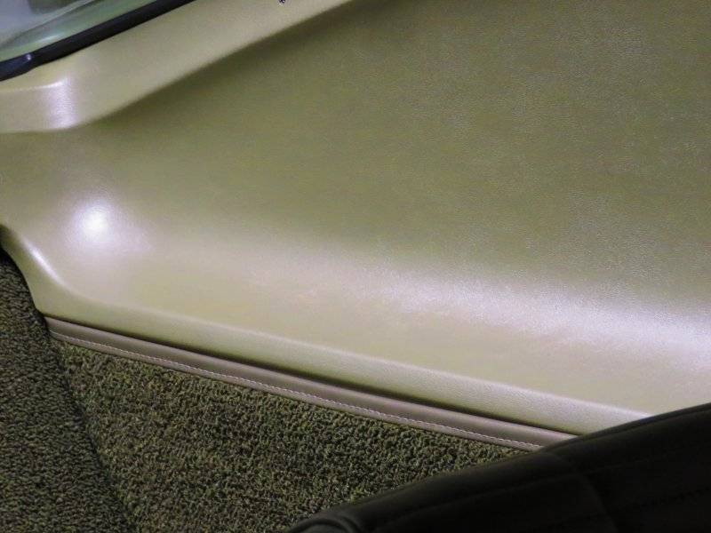

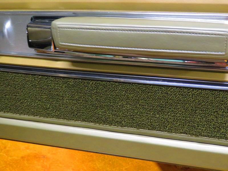

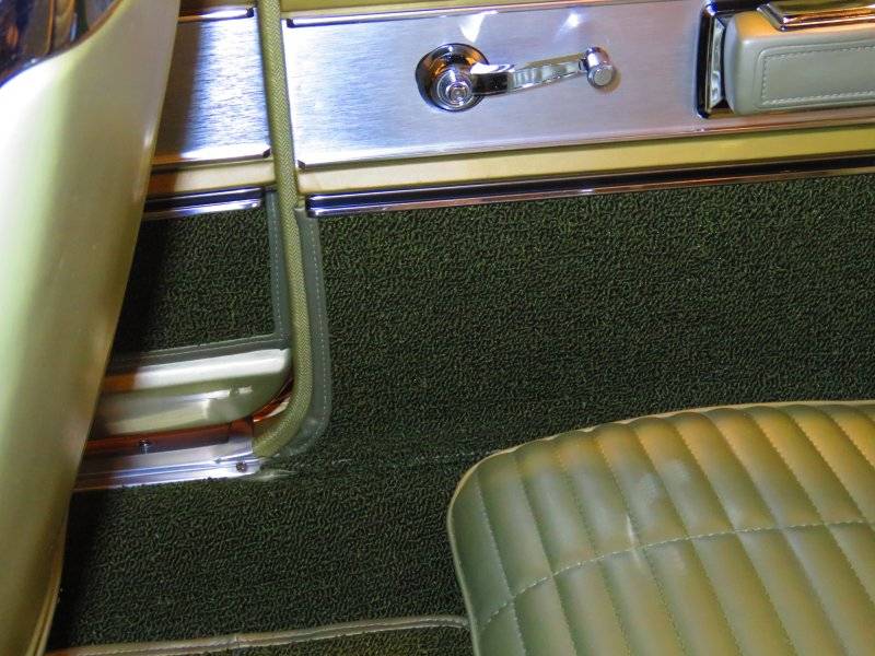

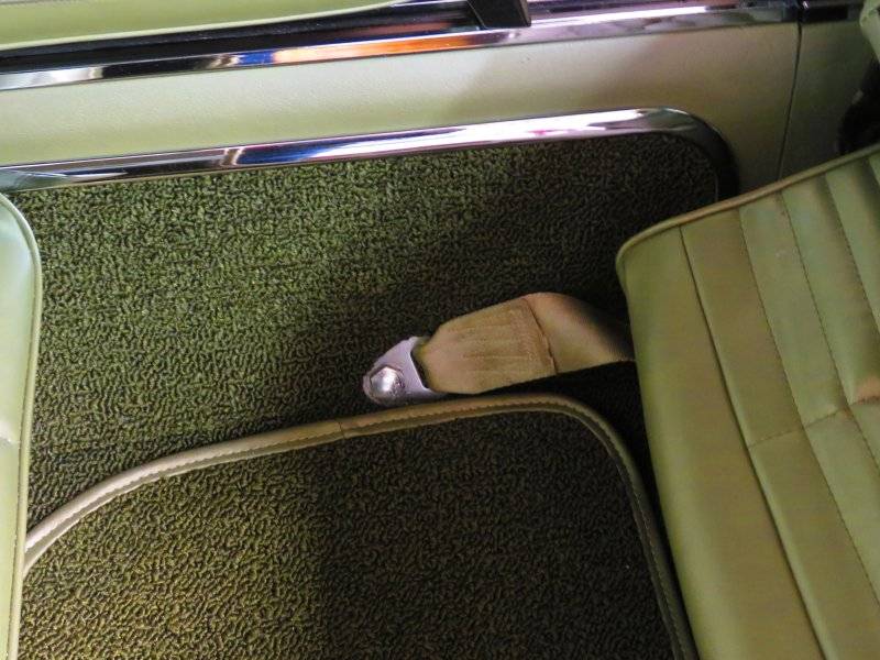

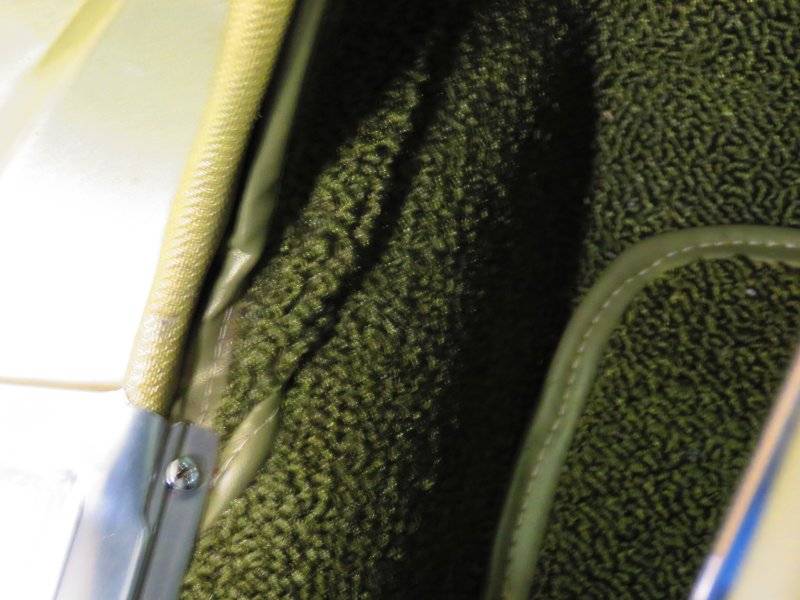

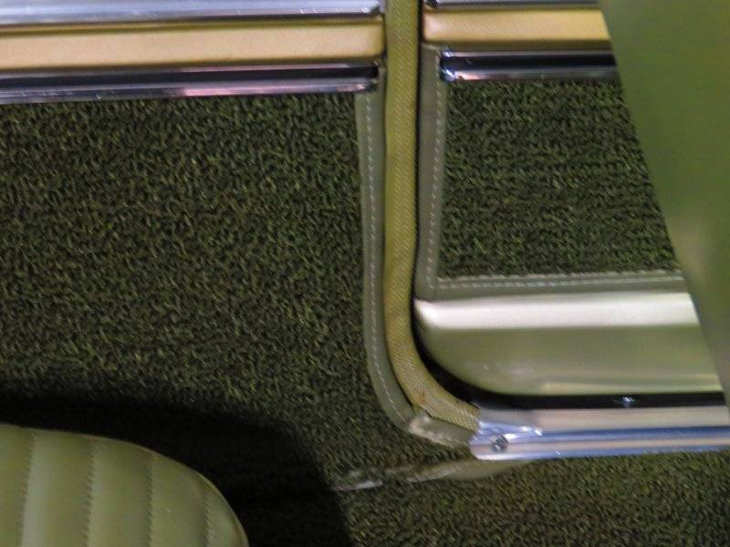

I carefully removed the old carpet and saved it as templates to install the new ACC carpet. The ACC carpet is good, but quite a few details or the originals are missing. I've got many photos of the originals. Here are some detail photos for future. Notice how many pieces have been sewn -- The originals were sewn.

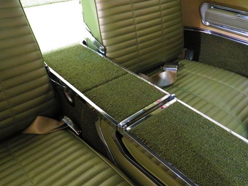

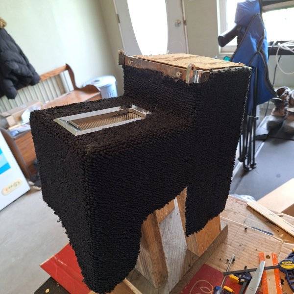

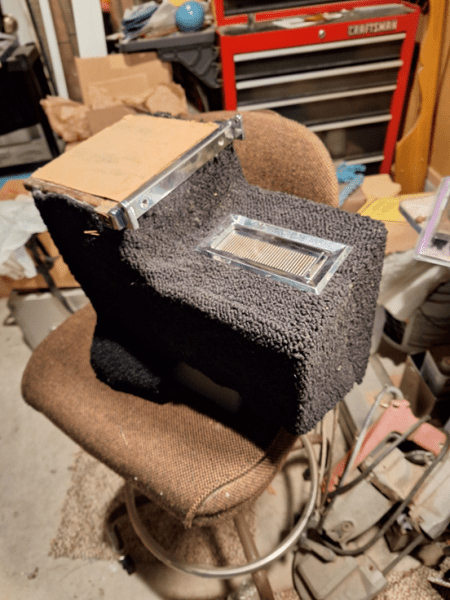

Just an FYI: If anyone is doing a 67, the preformed carpet for the rear console is not very easy to install and not nice when done. I came up with a way to cover using a roll of carpet and think it turned out a lot better.
Formed carpet: and Redo:
