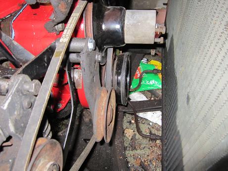

i have a 1966 satellite convertable 318 poly with air cond, power breaks,and power windows it is white with red interior. first the car has been sitting since 1973 and needs some work so i pulled the motor apart cleand the parts and painted everything .i changed the timing chain and put the motor back together. now my problem is the air pullys dont line up with any other pullys it only had 2 belts on when i got it .does any one know should the crank pully have 3 grooves instead of 2 i can post a pic if anyone thinks they can help. thanks rob

My poly318 with air has 3 grove pulley on the crank

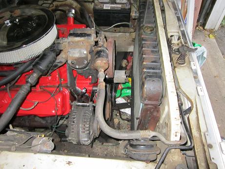

here are some pics
ok here is a pic of my pully the front thinggy is rubber not a groove ,it is a mystery to me why this is in here and not a 3 groove, thanks rob

next pic
here is another veiw.

That setup seems all wrong to me,i looked for a pic of my setup and just dont have one,and now ive removed the a/c ,hopefully one of the members will have a good pic,looks to me like you have some parts missing,mostly the proper pulley
I just bought a 66 belvedere convertable with a 318 and a/c,I'll try to get a picture this weekend
If you have a parts book or service manual for 1966 it shuld show you what they were from the factory.
