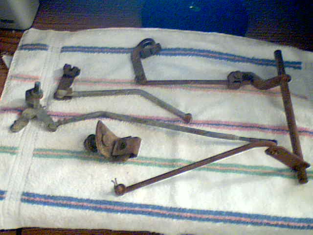

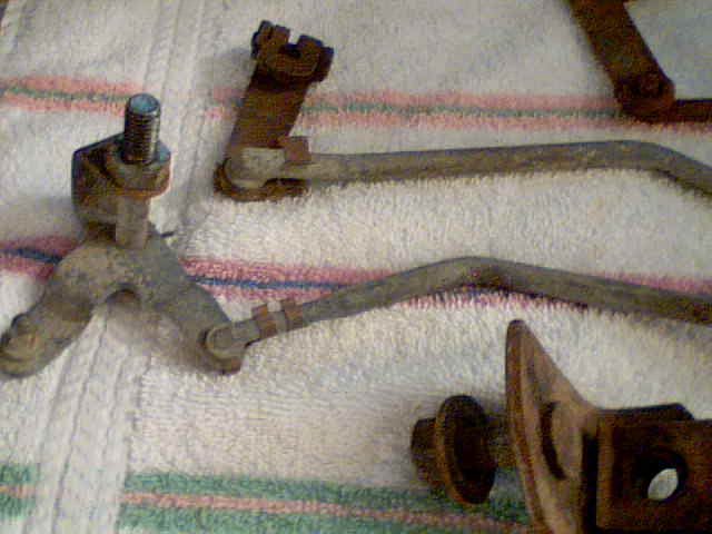

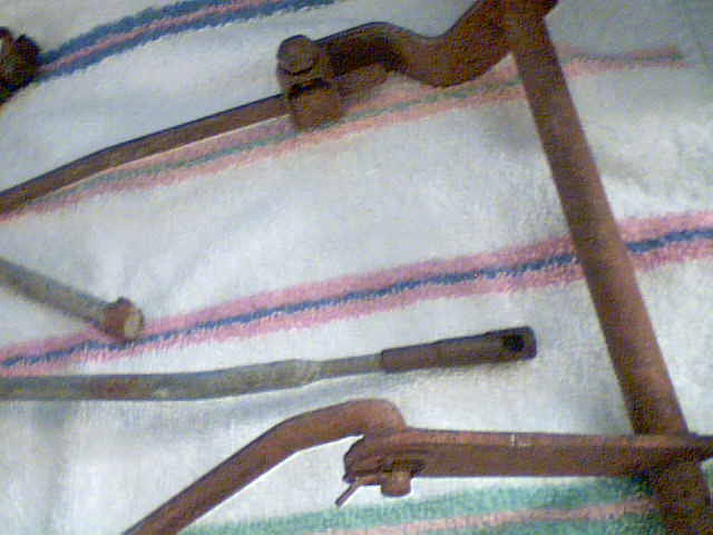

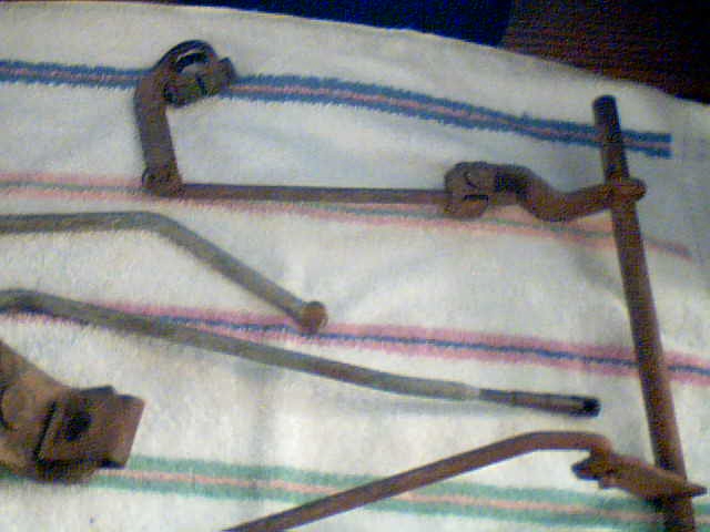

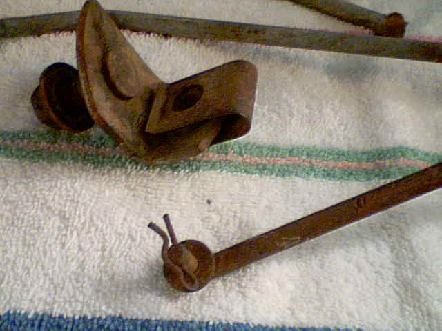

I have some transmission linkage that I took off a 1966 Coronet with a polyhead 318 727 small block automatic with a column shifter. I want to know will it fit all 66-70 B-bodies with a big and small block? Also is everything about the linkage the same as a floor shift car except for the one floor shift rod that I am obviously missing. Thanks

There are no console shift pieces pictured on this thread only the column shift automatic pieces and some kickdown parts which the kickdown pieces are different for a 68-70 . You are also missing the frame mount bracket for the column shift linkage. Yes the 727 column shift linkage will interchange with a block and 70 used similar pieces for the lock-out system but they are not the same
My 66' originally had a 361B big block. I am changing to a 440RB big block will the kick down linkages and parts work that was on the 361B?
