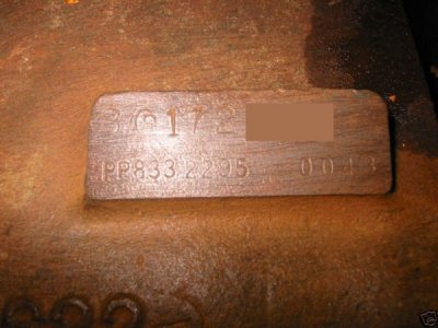

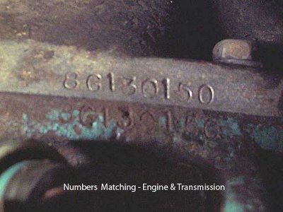

Doubtful if it has the C desigination for 1967 model year as there would be no VIN stamped on it. If it was a 68 it may have the VIN stamped on the back top of the block near the oil sending unit.
If the transmission is an automatic, it may have the VIN stapmed on the top of the bell housing across from where the engine would be stamped. If it is a four speed, it may be stamped on a pad on the passengers side of the tranny.
