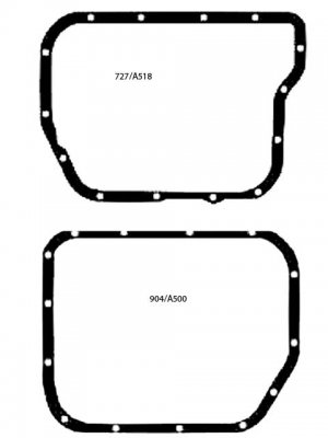

look at the pan..727 is top, 904 is bottom.
