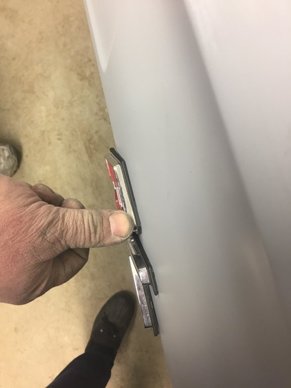

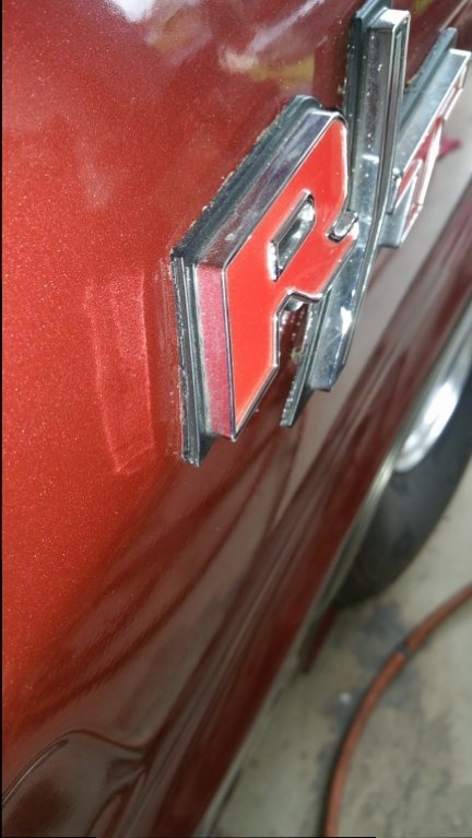

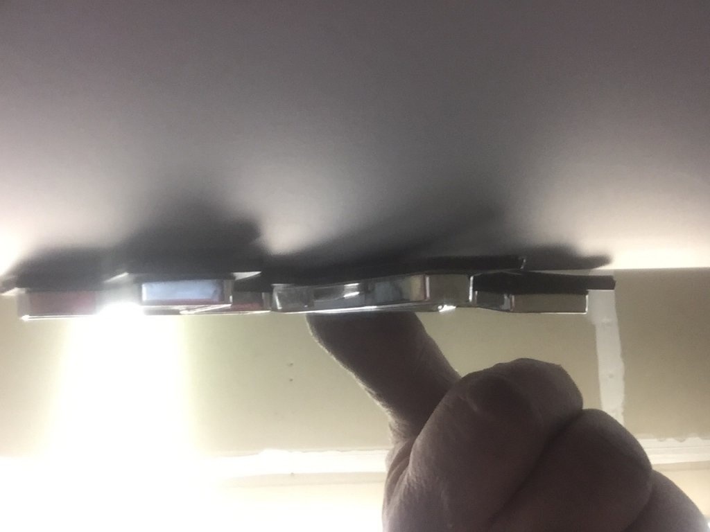

i bought some Nos 1/4 emblems from brads NOS that are advertised to fit 67s and the rock on the body line. The original one fits perfect. Looking for anybody who was able to make these work or anyplace to get new ones.

Nobody makes the correct ones for that body style. I had to bend mine but be carefull because they will crack. the letters fit ok but the slash doesn't. I didn't want to try to bend that. I'll post some pics tonight if I don't go to the track.
The ones you have are for a 69 Charger or Coronet RT, a Restorered set are going to run you big money like 1000.00 for a pair. correct number is 283.

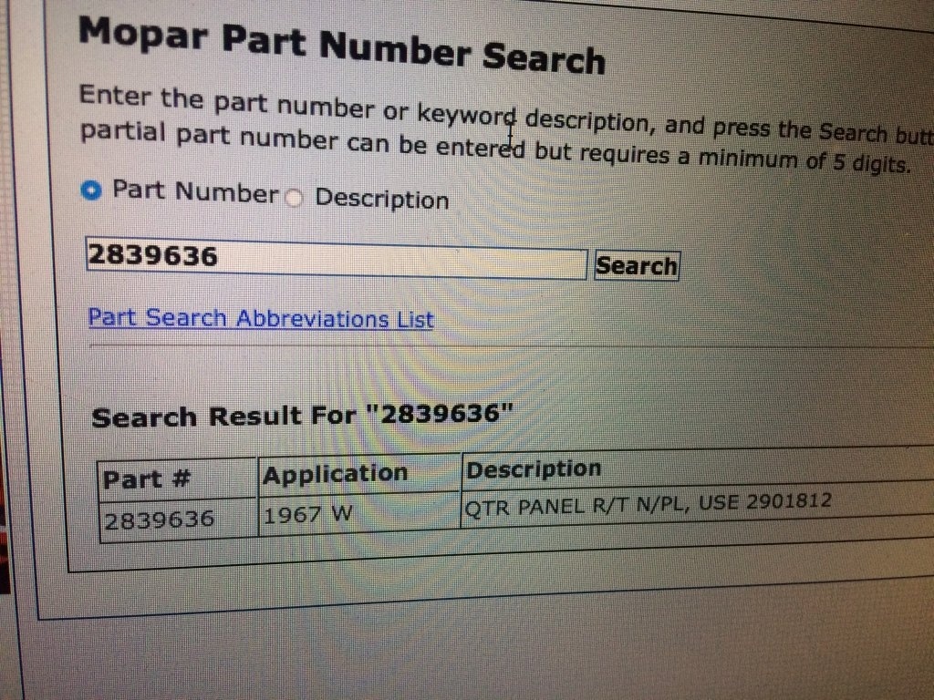

I searched the original part number and it shows the original is superceded by the 69 part number.

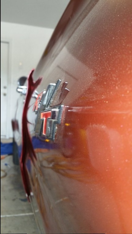

Sorry I forgot to post pics of mine that I bent to fit. As you can see the letters fit ok but the slash is still lifted.

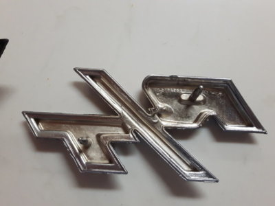

I may be parting a '67 R/T in the next couple of weeks. I may have one off my other R/T. When I removed them one side turned out to be a grille emblem with the mounting pin shaved off. And when they bent it they did crack it.
