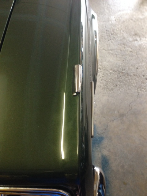

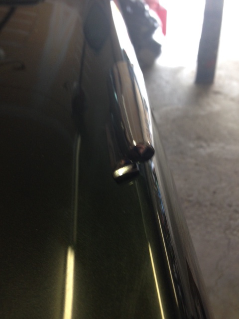

Wanted to bump this. I picked up a set and could someone measure from the back of their fender along the peak to the rear base of the indicator for me? Had some numbers from the front and I don't trust measuring around the curve. Thanks guys

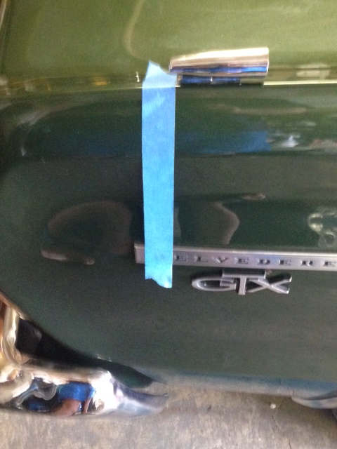

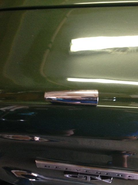

the signal rides on an angle on the fender body line... from body line of fender to driver’s door measure 48 1/4........ on my gtx letters it lines up with the “E”........
