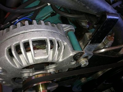

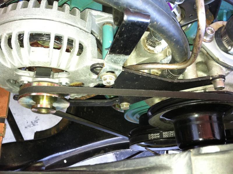

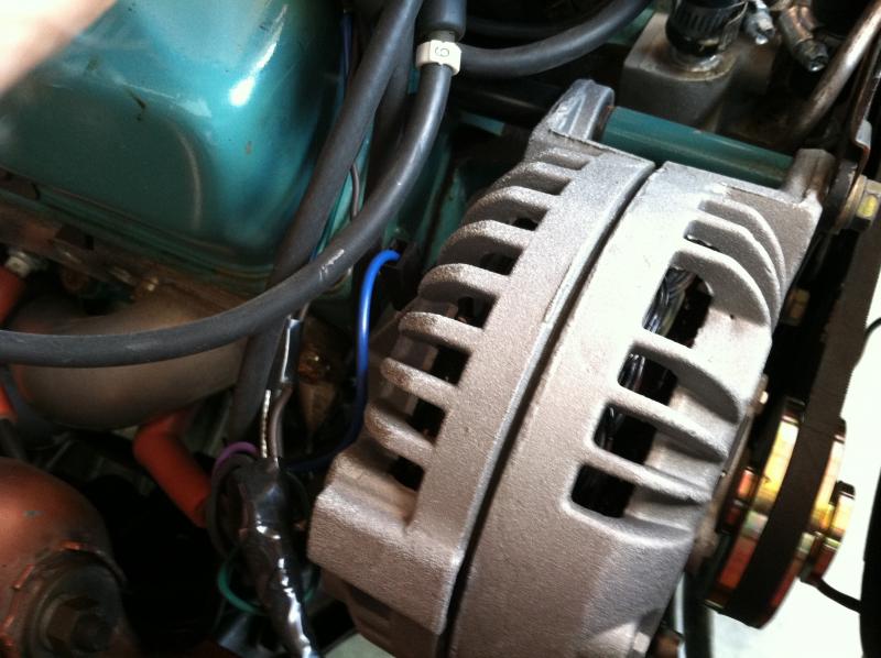

I removed my alternator and the lower bracket that bolts to the bottom side of the engine and I am having trouble reassembling. Can anyone tell me if there is a spacer that goes on the lower bracket between the bracket and engine block and the approx thickness. Also if any one can send me a close up shot of the alternator I would also appreciate it. Many thanks in advance.
If it's a non A/C car the lower spacer is 1 1/8" thick. Wheatfield? I'm not far from you- Holland NY.
Thanks for the pics. It did help. Is there any way you can tell me how long the back small spacer is. Mine is missing.
