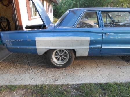

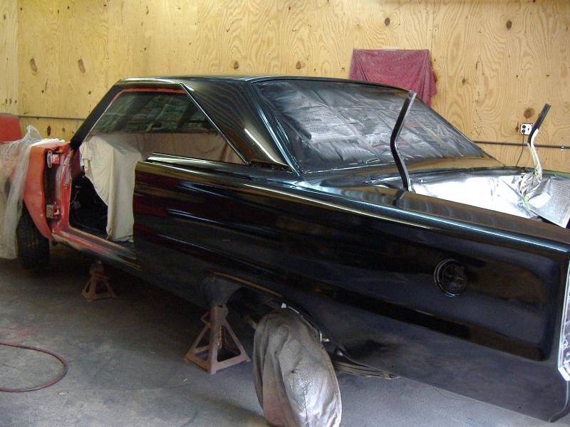

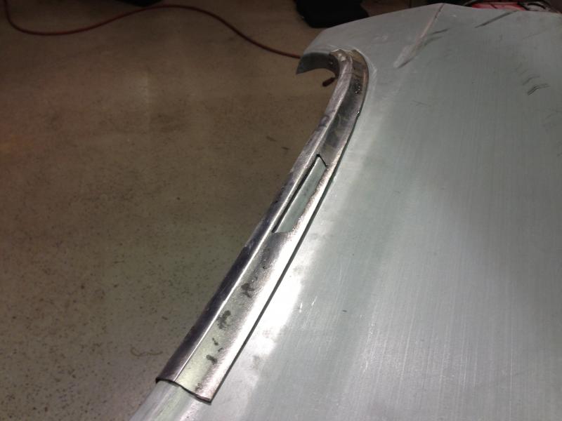

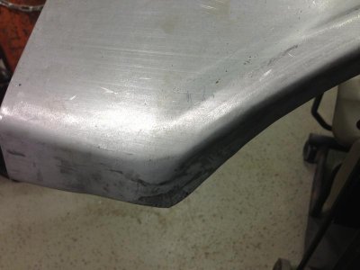

I have found (By experience) that all reproduction sheet metal for these car is garbage. The edges are not as sharp as factory and bottom corners for front and rear wheel opening is not even close. Fcatory openings are chisel sharp the repops are round. I basically spent weeks trying to hand form a sherman repop wheel opening to make it work. For the opposite side of the car im going to find a good donor maybe a 4 door and cut it out. Sherman, Year one, jc Whitney, they all suck!!!!

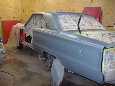

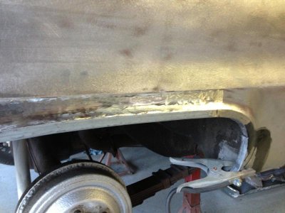

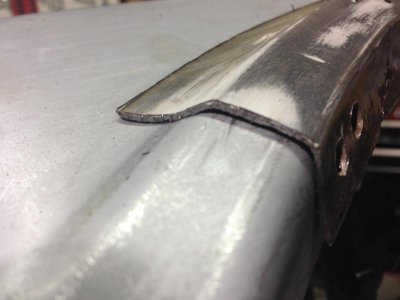

View attachment 144720View attachment 144721
Satellite Project (19).jpgSatellite Project (20).jpgSatellite Project (21).jpgSatellite Project (26).jpgSatellite Project (31).jpgSatellite Project (34).jpg
My brother used a patch cut from a 4 door.
The way water exits the area under the window is different, and the 4 doors are not as likely to rust around the wheel arch.
There was also enough metal under the door curve to cover the rust in that area on his 2 door.

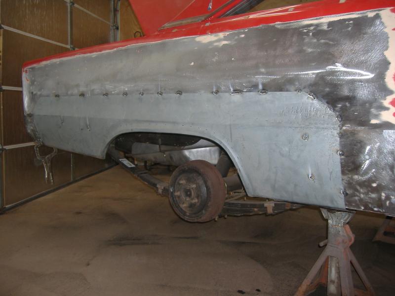

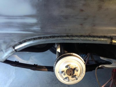

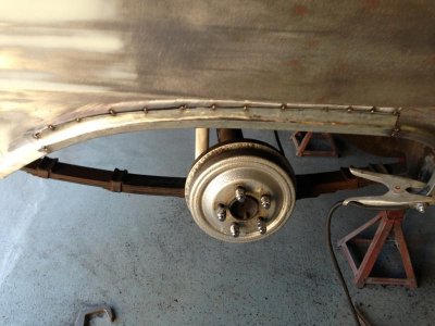

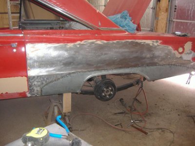

I bought the full patch panels off ebay for $299, shipped. They are USA made, but a little thinner than the original sheet metal. The driver side I cut to the lower body line, on the passenger side I used it all the way up. I thought it came out good.car 021.jpgcar 009.jpgmarx 008.jpgmarx 010.jpg
I personally butt-welded everything. If I had the abilty to make the pocket for the new piece to sit on top of I would have done it with a lap.
