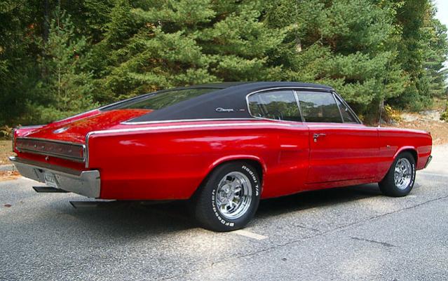

I have a 67 vinyl topped charger sitting on my rotisserie right now. The trim has been removed, but the glass and the rubber seal are still there.
Well its on a rotisserie so its probably getting a nice job on it and since the rear windows on these things leaked from the factory even Im sure you will run into this. Help me out here. Much appreciated.
Oh and that car wouldnt happen to be a california car that is red with a black vinyl top and factory L code 440 would it?
Nope... My 67 is a CT car... always has been... and none of my windows have ever leaked... at least not before I took it apart :)
