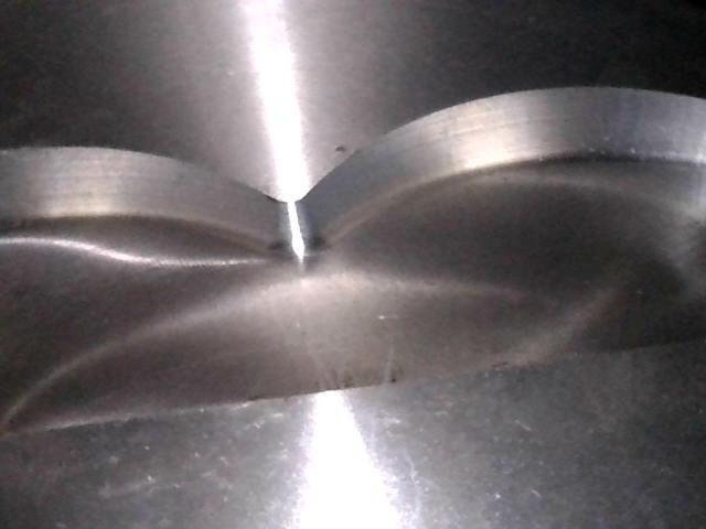

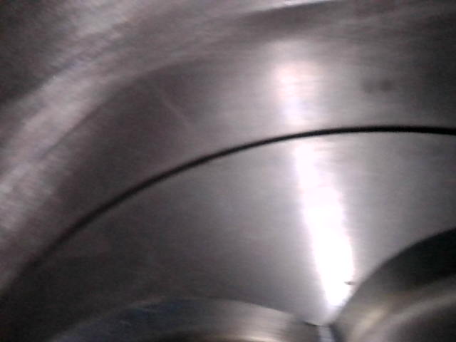

So my 68 road runner that I’m restoring came with the original numbers matching engine already rebuilt and assembled. I verified everything with the bore scope and she’s new. I was told it was built back to stock specs. How will the camshaft sound is my question? Not looking for a ton of power out of it as I have other rides for that. Looking for a cruiser that sounds good with this one.
If it truly is stock compression and camshaft it will have a fairly smooth idle. It will work well with the stock 383 magnum convertor if it is still there as well. It is really easy to screw up a 383 rebuild with too big of a camshaft and lousy compression ratio pistons.

those pistons/with big valve reliefs, don't look like 'stock spec' either

Pistons are forged for sure. I was told it was built right. I am aiming to to maybe take it apart and just check everything out and figure out exactly what I have. Gaskets are cheap and they painted it the wrong color anyway. Dang thing is corporate blue. I was told that was the pint the engine builder had on the shelf so he painted it so it wouldn’t rust. Lol
