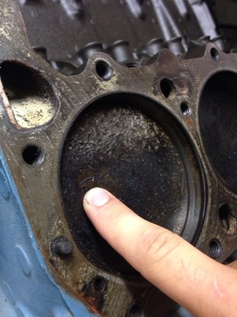

image.jpgSo when I tore down the motor I noticed the front cylinder is a little worked... Looks to be a valve imprint and some damage to the top of the piston. Something got pummeled in there..This I feel it where the bent rod came from....

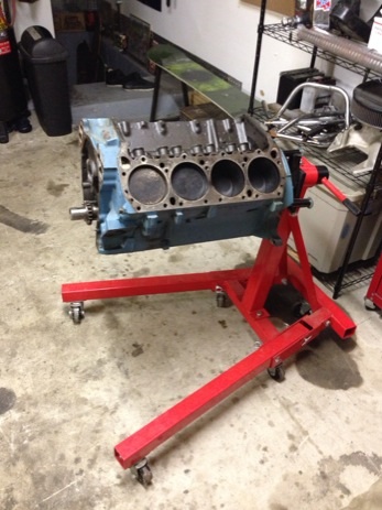

image.jpgDown to a shortblock

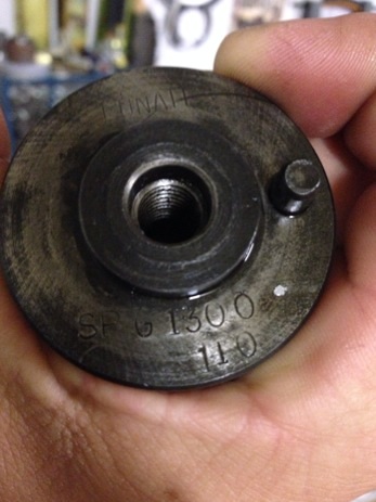

image.jpgThe cam is stamped "Lunati" SPG 1300 110? Can anyone help me identify this or tell me what I'm workin with.. Again the motor is .60 over with stock heads.
If your block is at .060 over already, should consider finding another block. .060 block is pretty much at it's limit.

thats what i heard as well, i guess ill see how bad it is and then go from there, I'm rebuilding the whole thing anyhow so it really would make more sense.

383 is a dang good motor. Had my share of them. Should be good blocks around...just need enough meat in them, to make them work.
If, and that's a big if, your 60 over bores would clean up with a light touch, possible it would go. But, kinda doubt it will. It needs to be right, if you want it to go.

I looked around on your cam and I found numbers but not those. Anytime I found lunati, it was with spc not spg. Spc....small block chebby.
Try contacting lunati..

thanks for looking! ill get ahold of them and see what the deal is. i never seen one like it before either.
