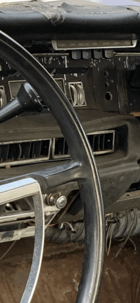

Hey guys, my 68 charger has the rear speaker option. There’s two holes above where the switch is supposed to go, is there supposed to be something else there as well, or did someone make extra holes for something?

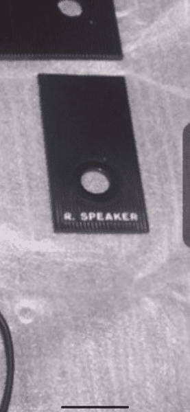

I also have a small rear speaker bezel that is probably aftermarket, is this supposed to go overtop of my bezel? Thanks for all your help FBBO!

Pretty sure the 2 holes above were added. The speaker plate goes over the top of the radio plate.
I believe there should be two holes. If you have the correct fader switch, it has a tang on it that fits in the upper hole above the larger bottom hole to keep it from turning. I don't think the upper (3rd) hole should be there. The plastic bezel is correct for your 68. I have the parts that came with my 68 Charger so would have to look at them to be sure though.
