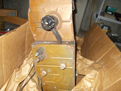

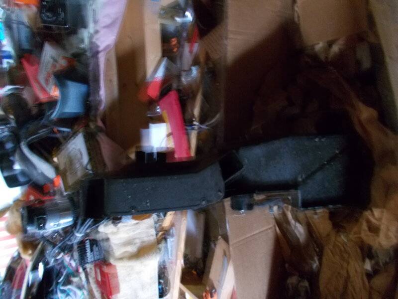

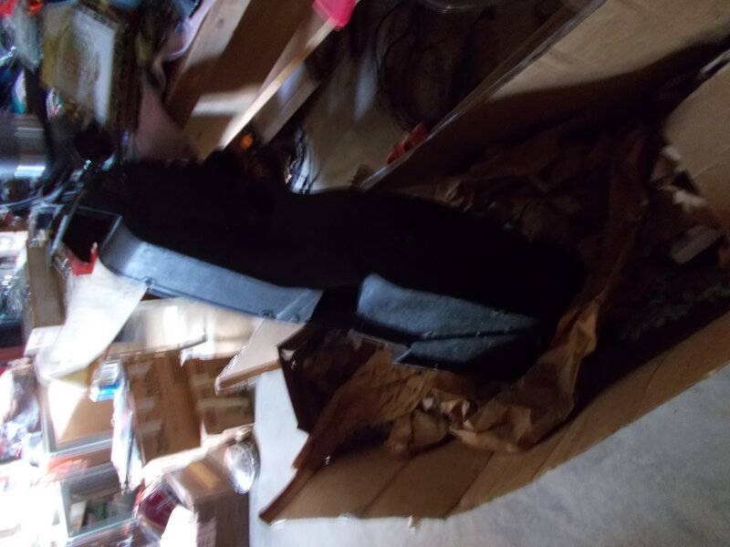

have a 68 charger heater box, has a stamp on it in yellow says MODEL 724,whats it worth? cant post pics ,,clean shape, all is there, what other models years does this part fit?? THANKS 4 EVERYBODYS HELP WITH THIS,can bring to the nats if any interest :)

pics added,will bring to nats if any interest :) THANKS TO ALL!!!

i respectfully disagree that they are all the same. 1966-67 have a slight difference in the housing and the temp door operates in the opposite direction compared to the later ones. 1968-69 and 1970 are the same housing with the 1970 having a different heater core. the part number stamp MODEL 747 should be a 1966 if there is a large number 2 after it then 1967. the linkage on the temp door for 1966 is it own animal too. if you could post better pics we will nail it down.

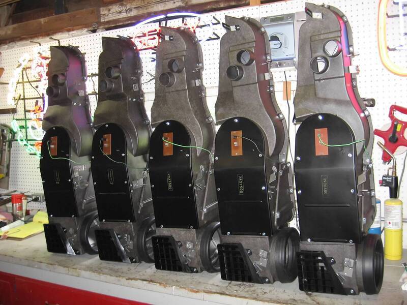

I will accept your answer, because I can't be absolutely sure. I have rebuilt several 67's and a couple of 70's, but other than cleaning, refinishing, and resealing, differences didn't register on me. I do know about the heater core, the only difference there is size of the two nipples exiting to the firewall. DMT's service kit worked on all of them.
