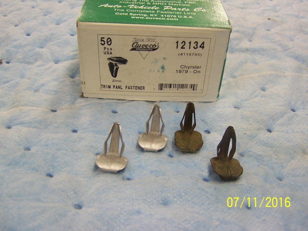

These are what I used. The green ones in the pic are from my 68 Charger. The zinc ones are from the box. They are Au-ve-co 12134. Box says 79-up but they are the same as the 68
