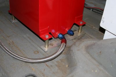

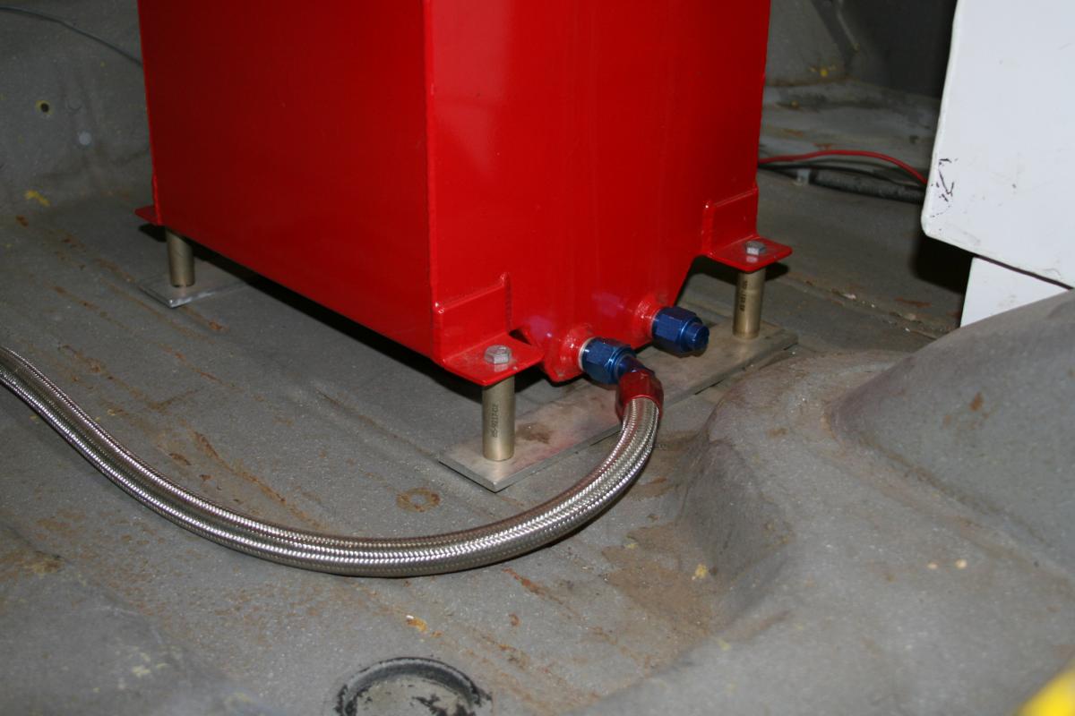

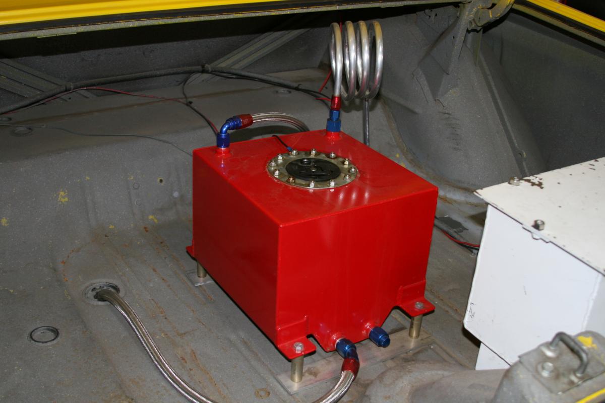

Here is how i did our car

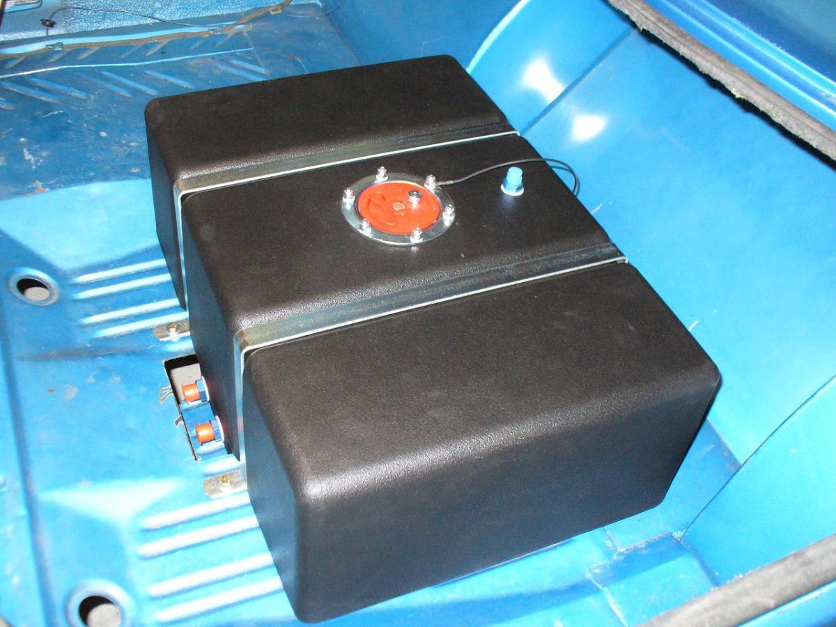

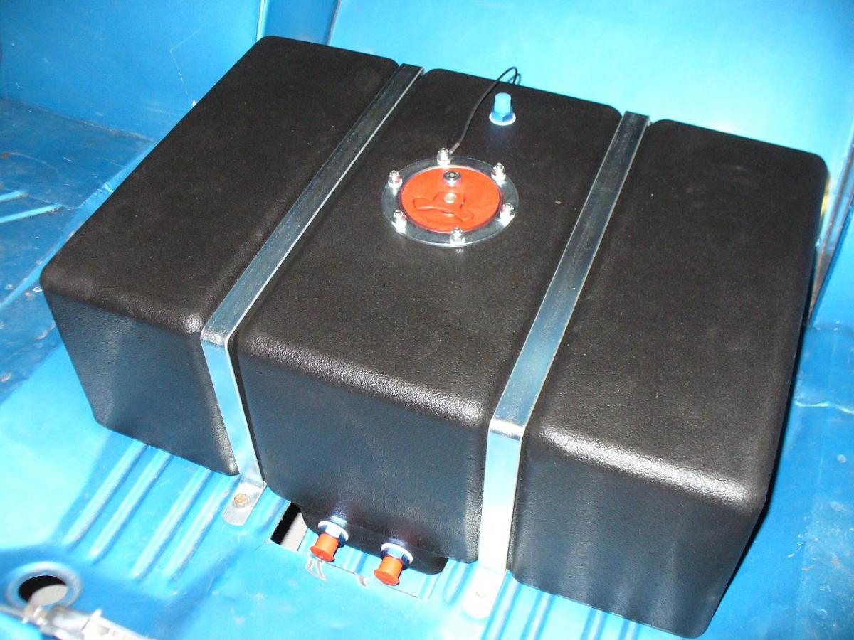

I've seen a few where guys would cut out the floor to get the lower feed and line out. NOT neccessary. Just stand it up a bit and run the line around and down.
