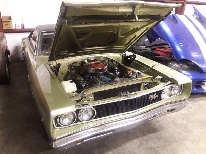

My experience in looking for a 68 R/T or even just a 68 Coronet were other than the normal rust areas mentioned are the rear tail panel and deck lid. It's almost impossible to find a replacement deck lid. I sold a 68 Coronet 4-5 years back because of not being able to locate a trunk or deck lid. The other areas already mentioned were very fixable on this car. After much searching I finally found a matching numbers 440, 4-speed R/T about 3 years ago. It was restored (at) in the past and at present I'm gathering a few parts for a proper restoration.
