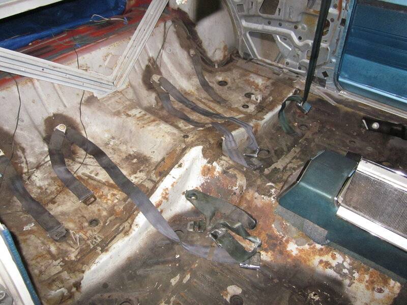

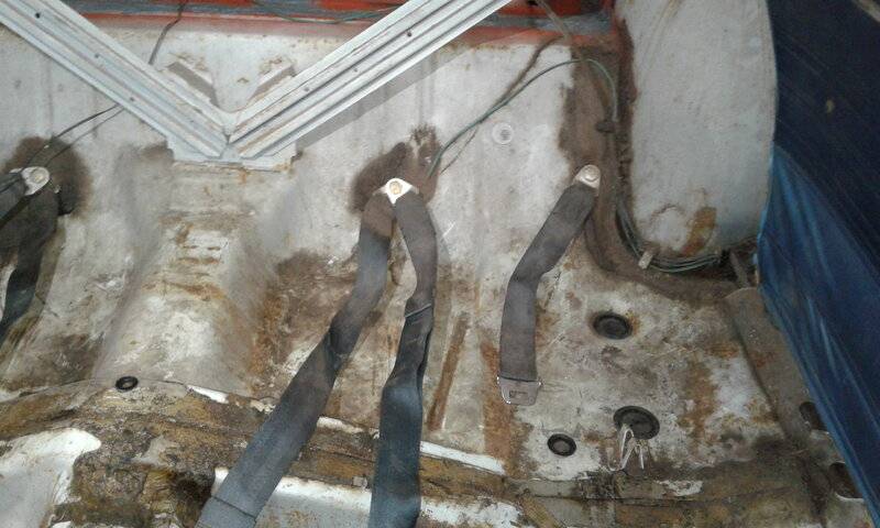

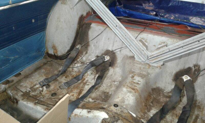

I had the USCT mini tubs installed and didn't take pictures of the rear seat belt locations. I looking for a pic of the outer belt locations. I am probably just going to weld a nut to a place and attach it to the wheel well. Thanks in advance.
From my 68 Coronet project archives. Hope these are helpful:
That works perfectly thank you. All my build pics are at an angle and its hard to see the holes. The new mini tubs cover over where the hole was. As I'm looking at my back seat I realized the frame rail runs right where I was going to put it. Looks like it will be plan B time.
Glad I could help. Good luck!

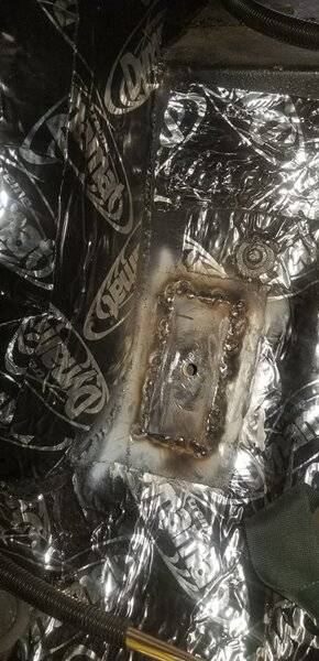

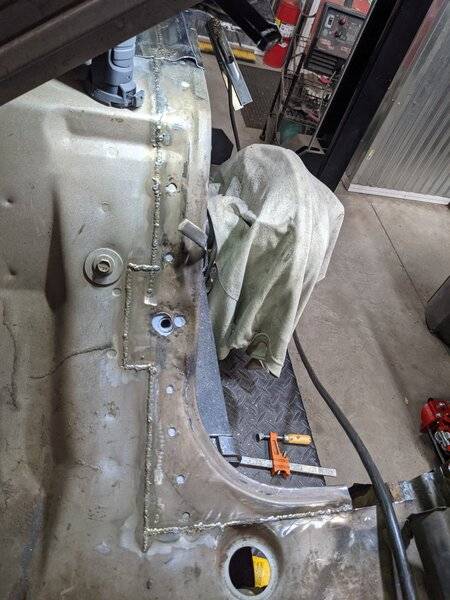

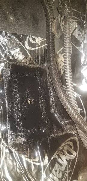

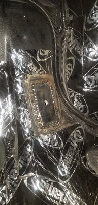

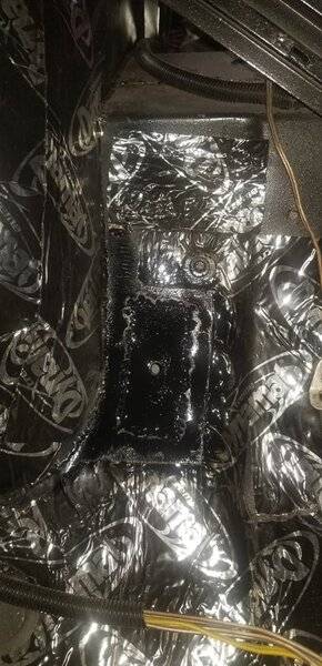

I would be weary about bolting to the wheel house personally. I relocated my mounting nut to inside the frame rail with the some heavy gauge steel backing it up to avoid pulling through the sheet metal.
Here is what I ended up doing. 3/16" plate with a Grade 5 nut welded to the back. Drilled a hole in the floor pan inside the frame rail to accept the nut. Then welded the plate to pan.
