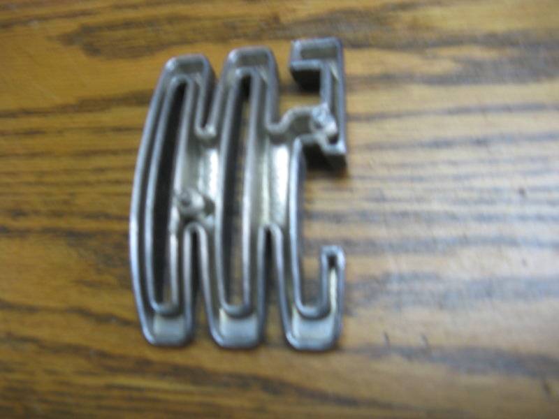

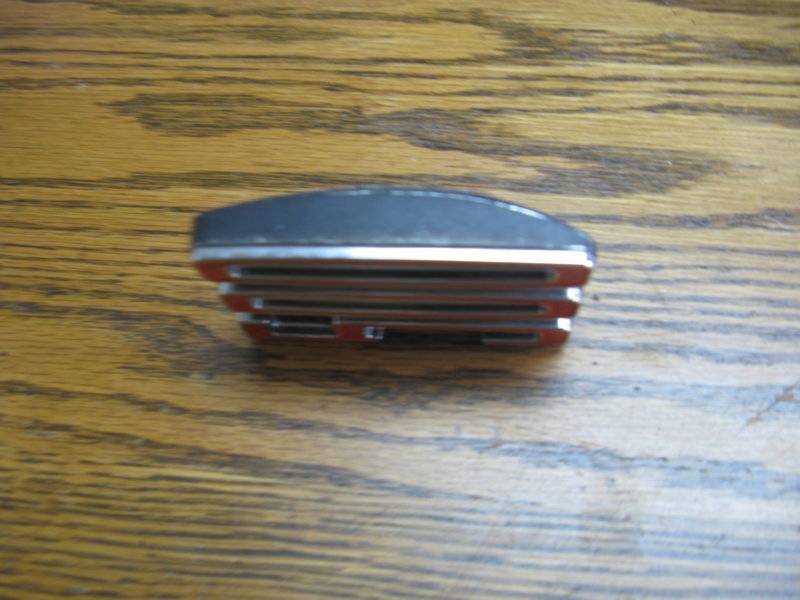

The panels for 500 and RT are exactly the same. The only difference is the emblems. I know they reproduce the RT, I just picked up a new one. Not sure about the 500? The emblems have grooves in the back that allow them to fit flush over the slots in the panel. Unique to this year/model. Are you looking for a 500 emblem? I might have one kicking around. Not sure of shape? Thanks again.
BTW, Do you know if they're reproducing the "R/T" or "500" emblems for the tailpanels, or if any reproduced emblem will fit good enough?
Year One sells a reproduction 68 R/T tail panel emblem but the 500 emblem is not reproduced. I picked up an Nos one for my 500 ragtop a few years back.

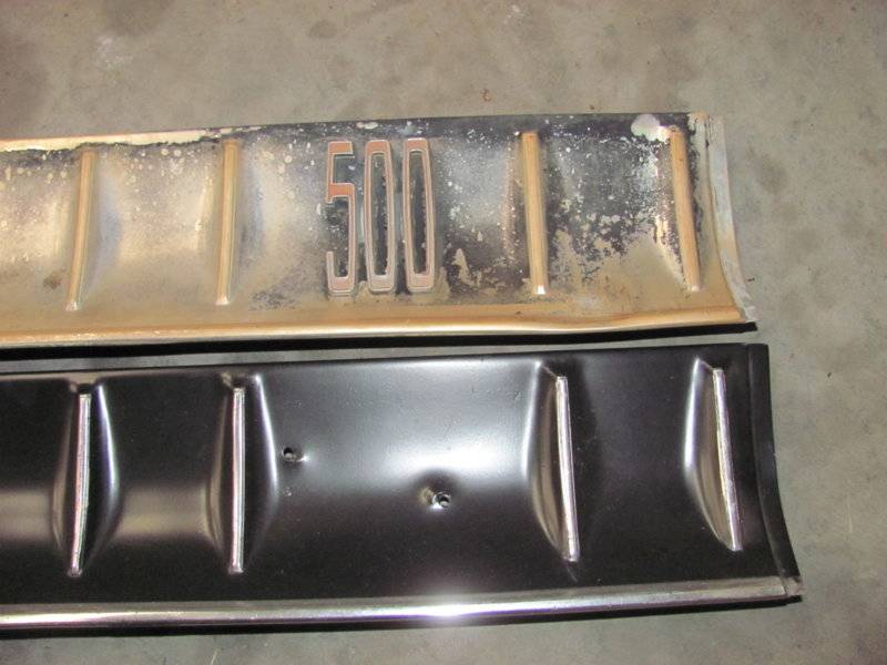

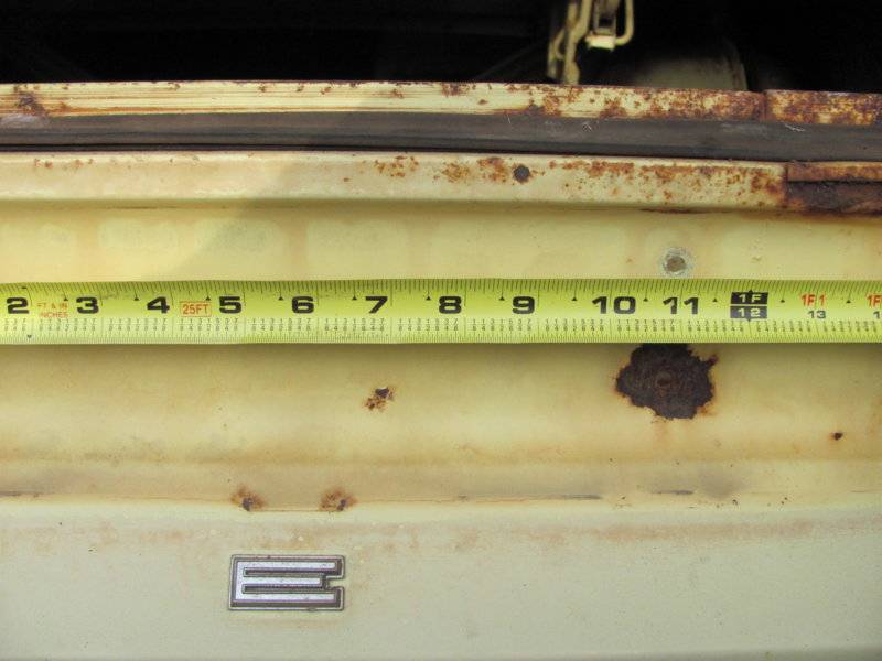

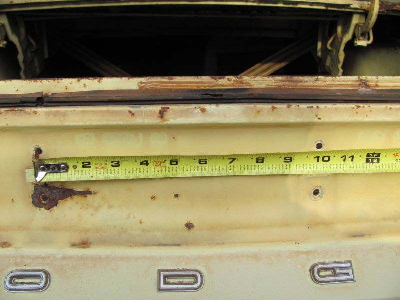

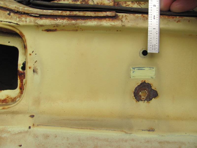

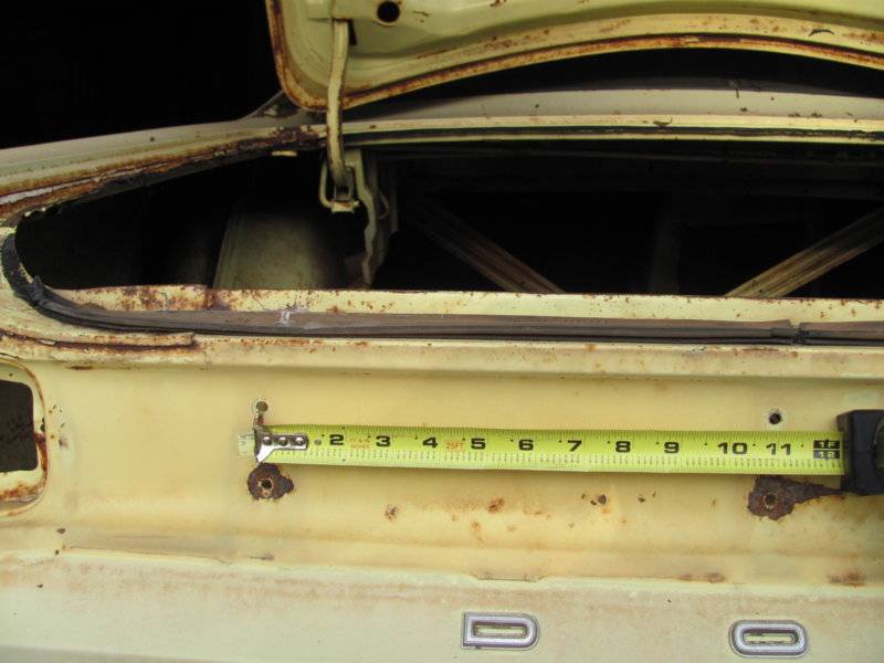

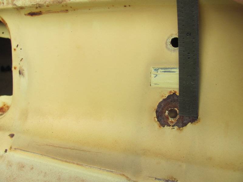

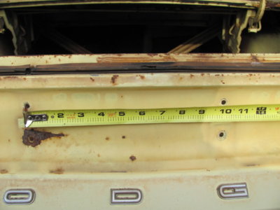

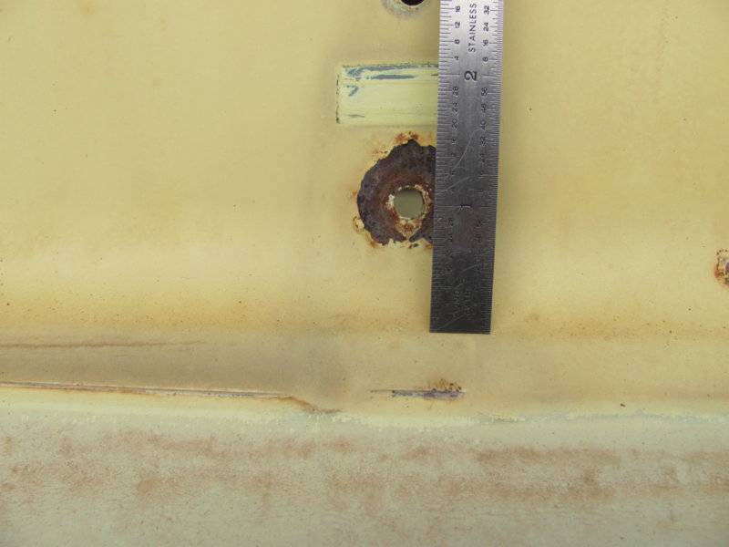

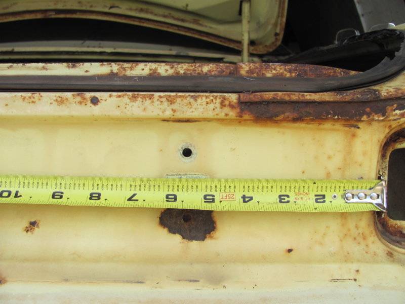

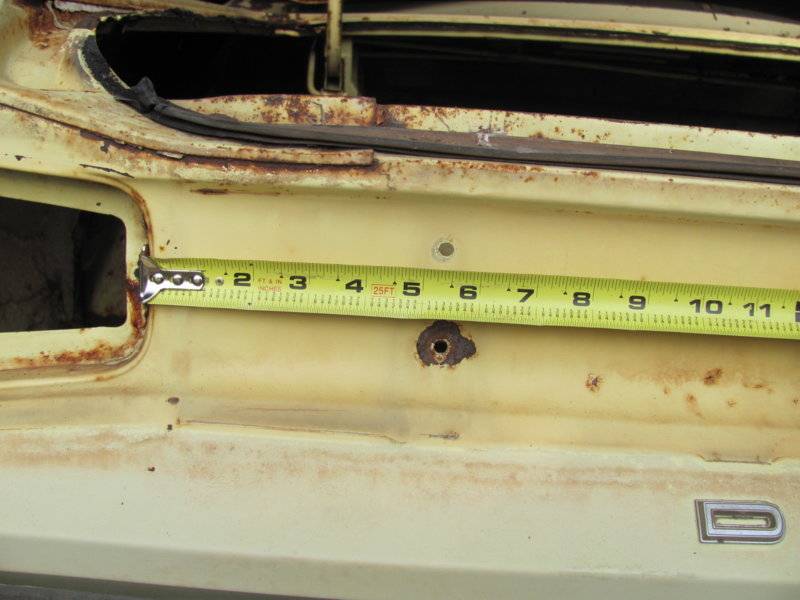

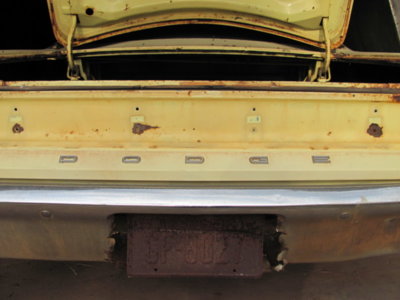

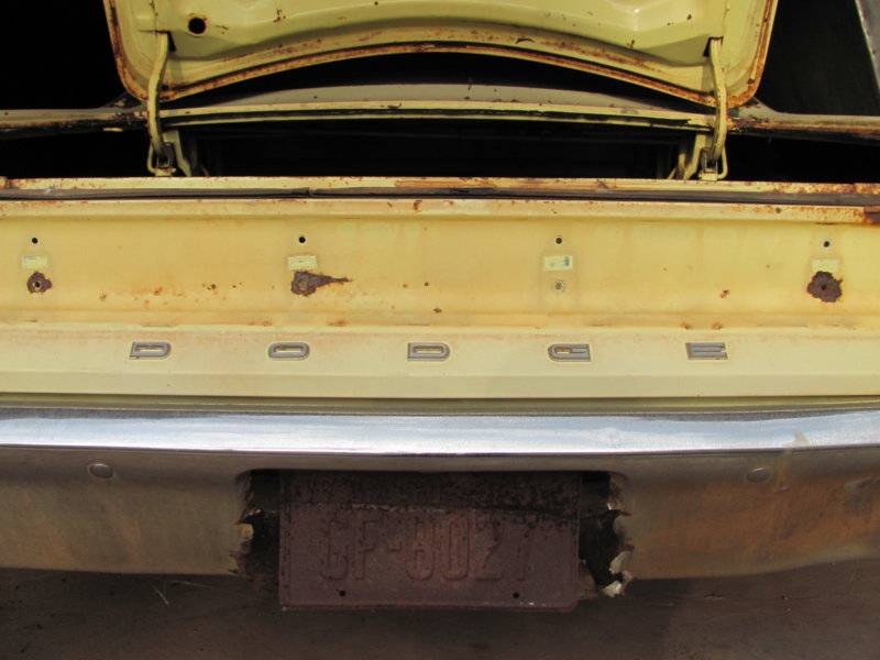

I was able to get out to the car today, I used inches to measure as I'm sure that's what was originally used. All my measurements are from center to center of the holes. The first set of holes are inboard of the taillight holes 5 3/8", the next set are 11" from the 1st set of holes. the 2 inboard sets of holes are 10" from each other and 11" from the outboards. The upper and lower holes are 1" from the upper and lower body line, and approx. 1 7/8" from each other. The holes are 1/4" diameter.
Edit.... after viewing the pics from my post, they are not as clear as from my camera. Rest assure I carefully measured and

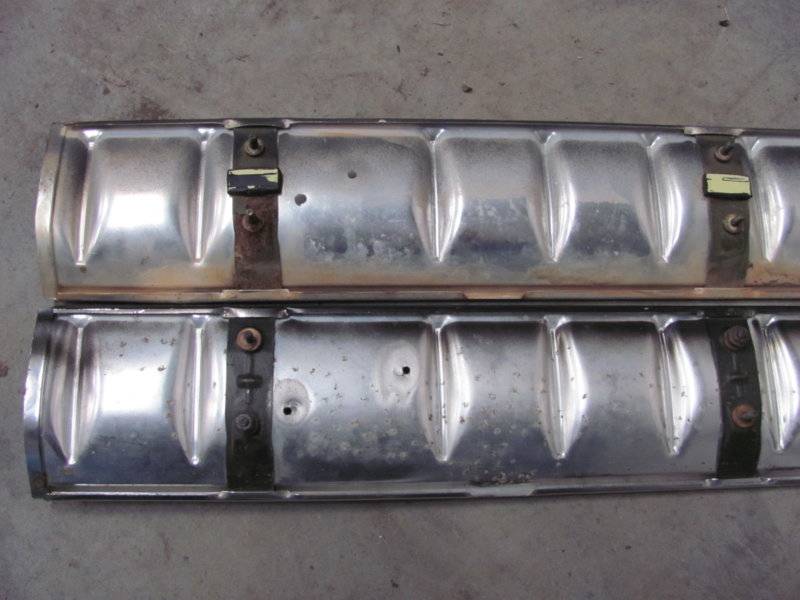

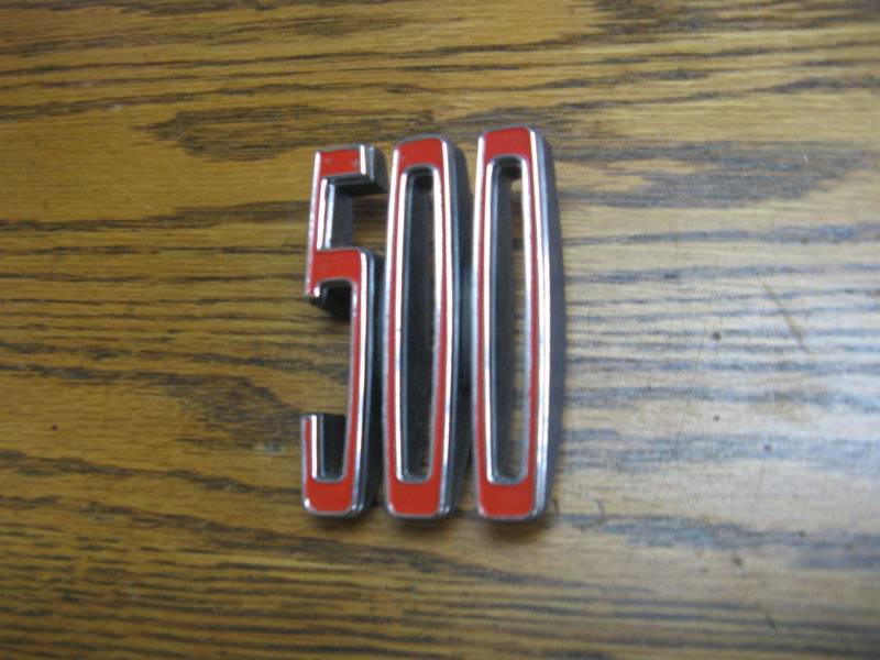

As far as the tail panel, I looked over mine and I found out I have one 500 and one R/T as the rivet holes are spaced differently. My 500 emblem looks good, just some faded paint, but I'm missing the R/T emblem. Good to know they're available at Year One.
IMG_5287.JPG IMG_5277.JPG IMG_5276.JPG IMG_5278.JPG IMG_5280.JPG IMG_5281.JPG IMG_5285.JPG IMG_5282.JPG IMG_5275.JPG IMG_5272.JPG
View attachment 744224 View attachment 744226 View attachment 744227 View attachment 744228 View attachment 744229 View attachment 744232 View attachment 744233 View attachment 744234 View attachment 744235 View attachment 744237

So both holes from taillight inwards are 5 /38? and all holes are 1 inch top down?
You rock!
Yes 5 3/8" from each taillight hole to the center of the 1st set of each hole.

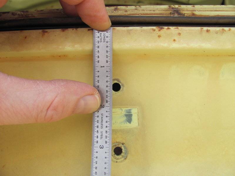

As far as the upper holes, It's probably easier to measure from the top of the panel, it's 1 1/2" from the center of each top hole to the top of the panel at the 90 degree bend. All 4 are 1 1/2".
