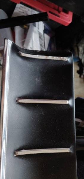

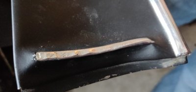

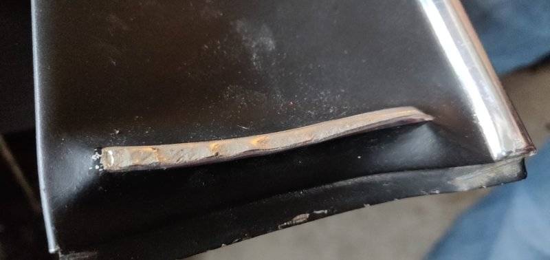

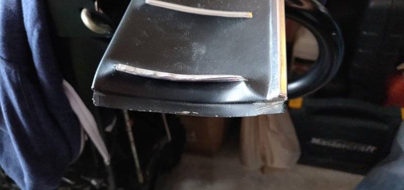

Post a pic, it might be able to be fixed.
Any ideas in how to repair this?
Really nice everyone other than this one area. Bad repair and crushed pretty good on the side. I should be able to slowly bang the dent back into shape, but no idea how to clean up the slot?
IMG_20190408_111027.jpg IMG_20190408_111010.jpg IMG_20190408_111014.jpg IMG_20190408_111001.jpg
Knock the dents out, the rib can be flattened back out and a little bit of body filler, prime and paint.
Flattened how? Banged out from behind? The ribs remain unpainted, just anodized right?

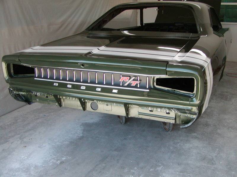

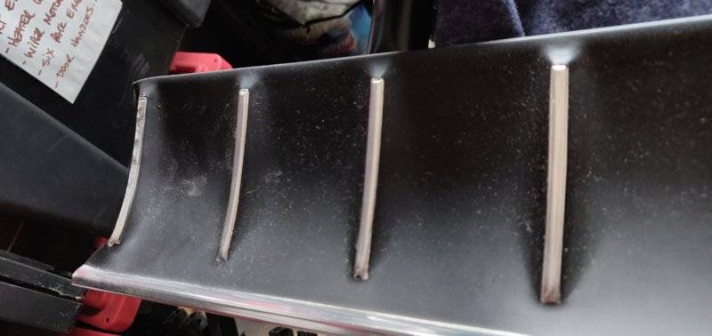

I used a tool similar to a screw driver with a rounded end like on a paint can opener. Placed the tail panel face down on a firm but soft surface like a sandbag and gently worked the ribs back into shape. It takes some time and patience but you can get it done right. I then taped off each of the ribs and painted the panel. After removing the tape you can touch up the ribs with a Scotchbrite pad or some fine sandpaper. Again its like performing surgery where slow and sure is better than quick.
