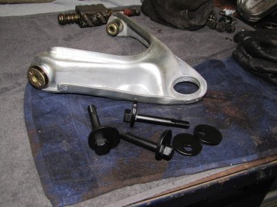

The colors of the control arms are often dependant on the assembly plant the car was from. The "gold cad" was actually not cadmium, but an anti corrosion type of Cosmoline that soon dried and wore off. Most cars that I have seen have what appear to be bare steel showing. This indicates that most cars had that gold appearing color when new. Low gloss black is also seen frequently on restored cars. Not flat, not gloss, but a low degree of gloss.

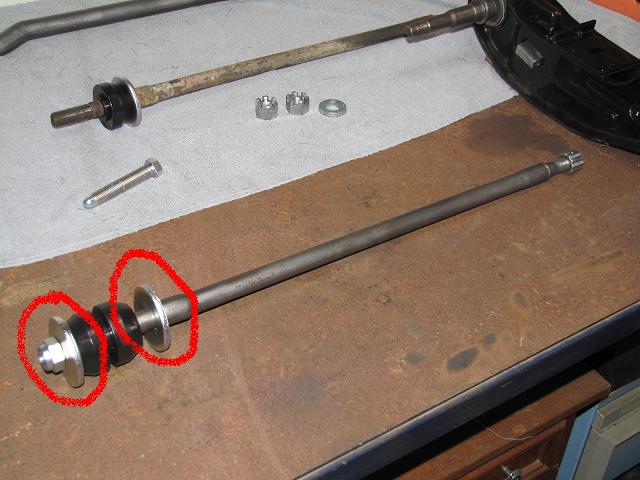

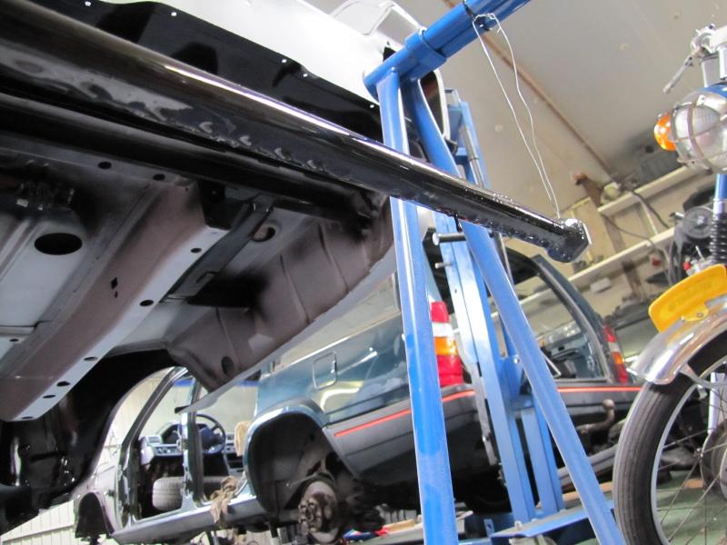

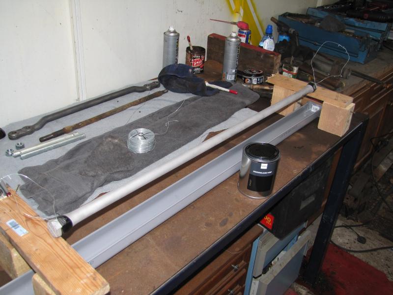

Some suspension pieces were natural steel in color. The strut rods and steering linkages were natural. The torsion bars were dipped in paint horizontally and should show drips if you're looking for a factory correct appearance.

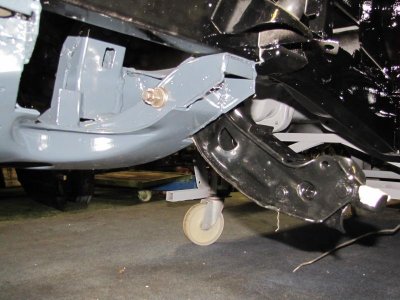

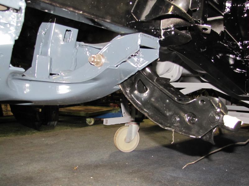

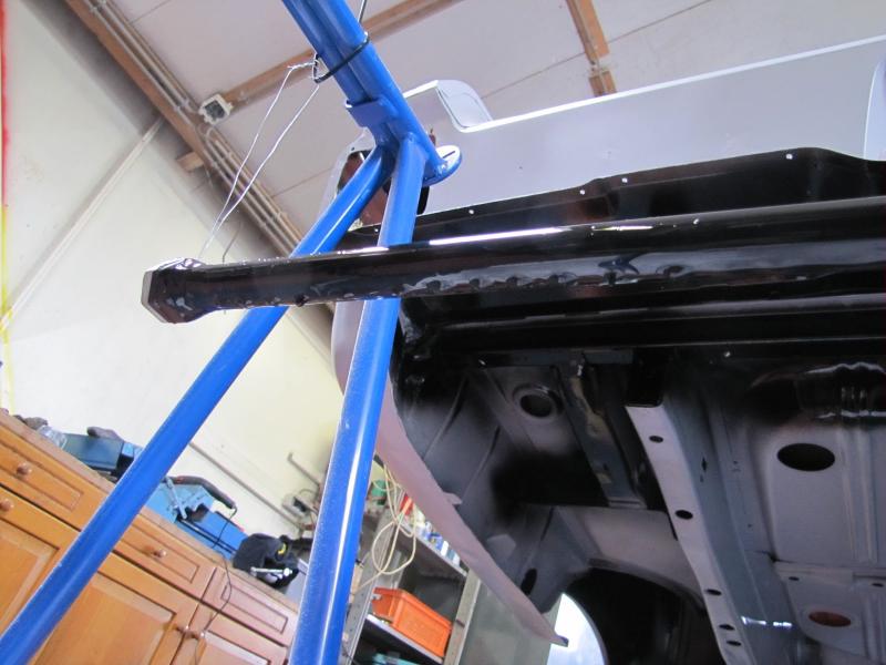

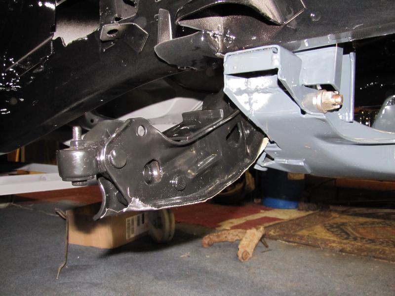

Goodmorning,
i have attached some pictures from my 63 Savoy.
you could also check my blog for more details. www.mister4speed.blogspot.com
this is very very helpful also:
www.mmcdetroit.com
Best regards from Holland,
Marcel
more
In 62-65 some lower ctrl arms came bare metal ( without the cosmoline-treatment ) and others came in a flattish/gloss black, as Gregory C said.
