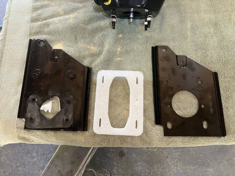

The manual brake and power brake systems have different firewall support plates....
The one on the left is for manual, the right one is specific for power brakes. The Power brakes use this linkage....

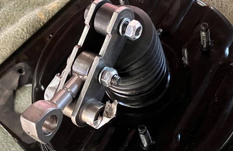

You can buy that new too. When you install it, do NOT fully tighten down the nuts or the brakes will not release, the pedal will stick to the floor.
The booster attaches directly to the firewall. ALL the linkage fits inside, under the dash.
