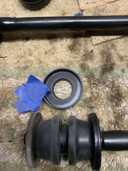

Front of strut: I have one thick washer in back and front. Where does the light tin washer by the blue tape go? Thanks
In other words, the assembled pic is all you need. Two bushings, two washers and a sleeve. That light one is extra, or from something else.
Not necessarily... Like I said before, post a picture of the bushing taken apart.... There were some upgraded design strut rod bushings to used a washer similar to that... It would go in the hole in the K member and lock into the rubber bushing...
