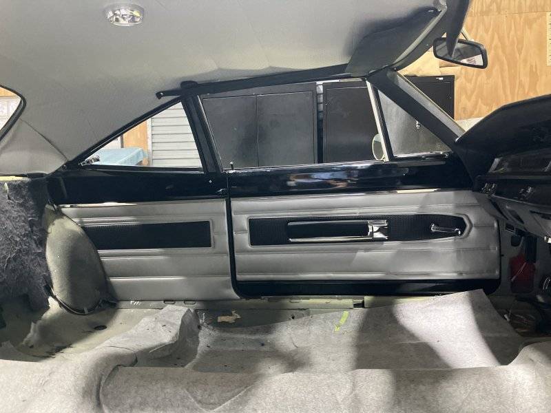

The black metal interior trim on the side and from holding the headliner, what sheen is it, gloss, semi gloss, or satin? Thanks!
In my 68 road runner it was gloss black and that’s what I repainted it with
Front upper headliner trim is painted with textured acrylic lacquer same as dash frame. Pieces above doors are same as exterior with gloss sheen.
