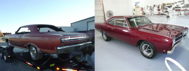

Love the GTX, sir - but then, I'm kinda partial to 'em, as you might guess:

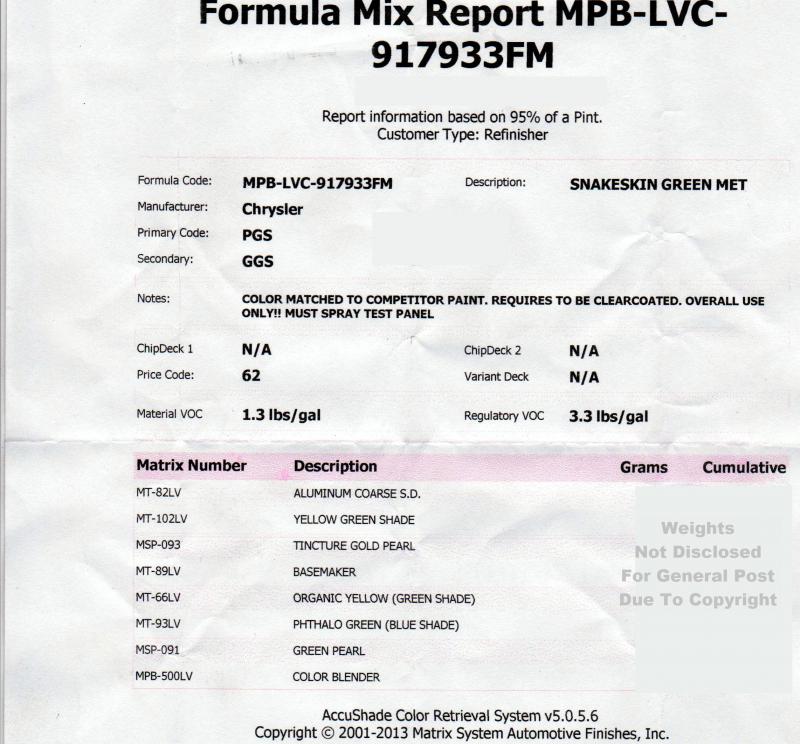

I'm digging that decidedly non-stock paint job especially. What color is that? It fairly GLOWS!

Re: reverse lights - I wound up wiring mine fresh. My GTX is a 4-speed conversion by previous owner and the reverse light wiring going through the firewall simply didn't exist. It's not that bad, although yours also entails the neutral safety in the switch on the 727 if I recall correctly.
When you look at the pic I posted above (car found in field), you can imagine a LOT of things got rewired, mostly by me.
Former owner sez "I'm no mechanic" LOL - but he did a sweet job of doing all the metal replacement and bodywork.
Love your ride, Oldtimer!

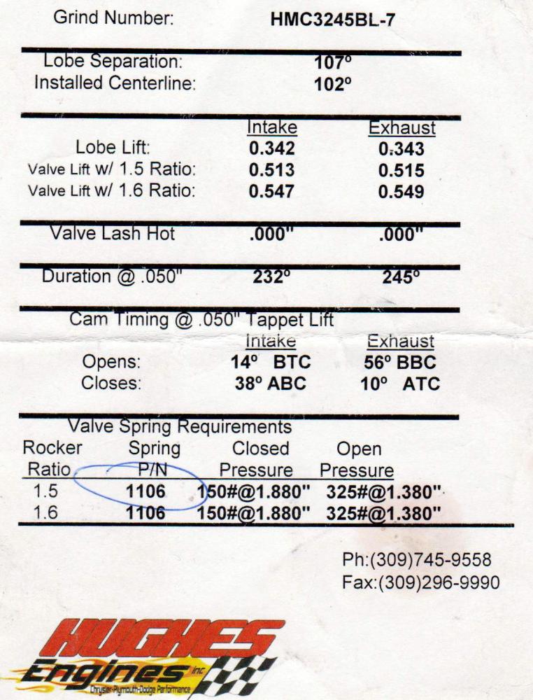

Hi Moparedtn... Your X looks great!
In answer to your questions and comments about my cam choice and the paint job, given copyright issues, I have scanned and posted only a limited amount of information about the cam
and the paint, which should be enough to guide you, and/or perhaps others, in the right direction(s), should anyone be interested.
The original paint can be easily found through normal means, or mixed from scratch by your painter. The formula will vary, depending upon the brand of paint being used, but this gives you a general idea of what all goes into the mix.

Yep, yours is quite a bit more cam than mine.
