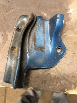

I'm looking to replace the door end seal on my 1968 Plymouth GTX Convertible. Does anyone know who has a pair of them. Has to be for a convertible.
Door seals for hardtops, sedans and convertibles for the 68 to 70 B-Body model line are all the same. So it is not a convertible specific item. We sell a reproduction piece, but like most reproduction pieces, they do not fit as well as the originals. Personally, lightly bead blast the part with some well worn media which is not that aggressive. Once the majority of the paint is removed, wipe the remainder of the seal down with lacquer thinner which will remove the remaining paint. Save yourself the $30 plus shipping and have a superior part with a minimum amount of labor.
I swapped mine out with "hardtop" ones & they looked the same as my original convertible ones.
