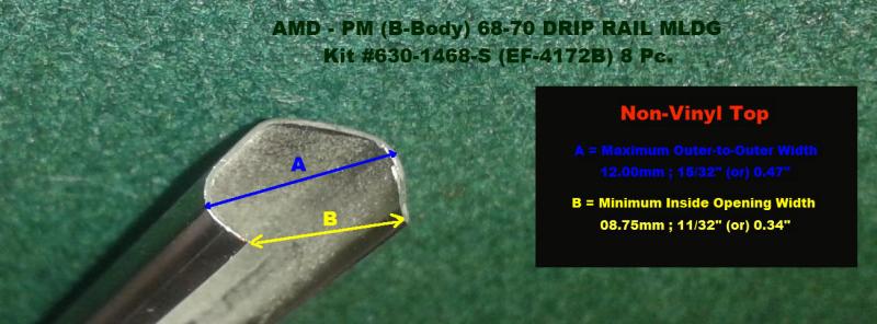

I decided to phone AMD directly, about their kit and was told:
The AMD, 8 piece kit is for "Non-Vinyl" Tops (ONLY)
In addition, they don't make an alternate kit for Vinyl Tops, due
to the lesser number of - Mopars - that would require such a kit.
This was not good news.

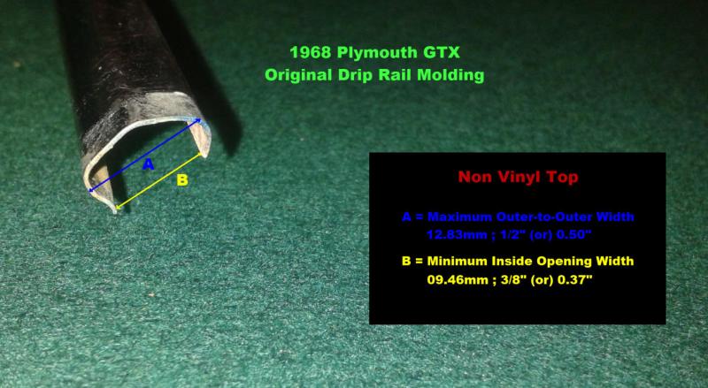

Unfortunately, my 'Original' moldings, have a few pry marks and
scratches, that may or may not be repairable. Although this car
will be a driver, my wanting to re-install them, even if I could get
them to fit, is not my first choice.

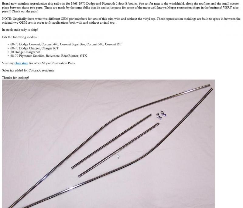

Interestingly enough: eBay is now currently listing two drip rail
molding kits for (68-70) Mopar B-bodies. One is made by 521
and the other is, yes, reportedly being made by AMD... WtH?
I was just told by AMD, they didn't make such a kit. Hummm!
Are you starting to get a sense of my confusion & frustration?
These kit(s) are now 'clearly' being advertised as:
Quality, Newly Tooled & Multi-Purpose
Drip Rail Moldings for both - 'Non-Vinyl' & 'Vinyl' Installations.
It would be interesting: to know the "A" & "B" measurements
of these 'latest and greatest' moldings.
I will try asking.... Wish me luck.
PS:
I suspect the 1mm difference in size between my original
moldings and the 'smaller' AMD product, shown in these
pics, is due to the originals having been installed; 47 yrs
of use; and final stretching incured, during their removal.

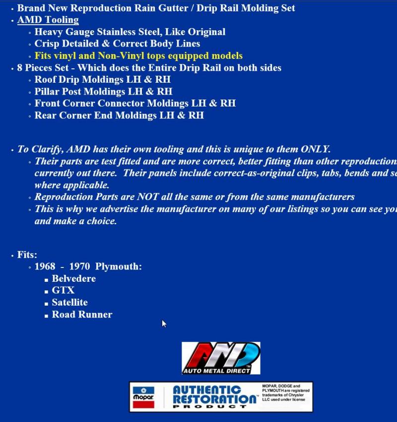

Thanx for the update about 521. I have since revisited e-Bay and grabbed a couple of screen shots illustrating: a reputable vendor selling AMD moldings, who claims they are suitable for both Vinyl and Non-Vinyl Tops; and a reputable vendor who is offering moldings, initially distributed by 521, who is also claiming the moldings are suitable for both applications. If these are both AMD kits, and they are in fact suitable for both applications, It would appear that I have been misinformed and lead on a wild goose chase by AMD. Out of curiosity, I have asked one of the vendors to confirm the manufacturer and to also measure his molding product in a similar fashion, for comparison to my known AMD measurements. It will be interesting to hear of the results. More to follow...

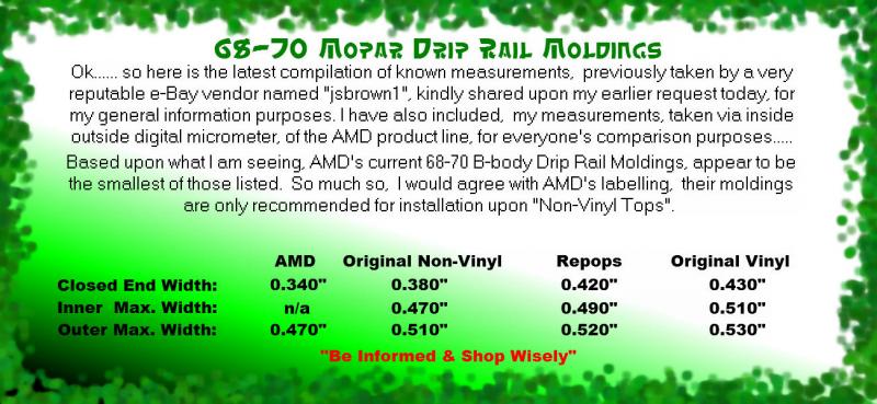

The following illustration, is a recap of reported sizing information, I have been able to dig up on this sorted topic. Based upon this new found knowledge, although a quality product, I will be returning my AMD moldings, are they are clearly not intended for my "Vinyl Top" application. Thankfully, I learned of these differences, prior to my installer potentially ruining one or more of the incorrect AMD parts. I must now place an order for moldings, more likely to fit - less all the hastle. If nothing else, I hope my efforts to document this fiasco, will assist 68-70 B-body owners, should any of you decide to go Vinyl. Cheers :)
