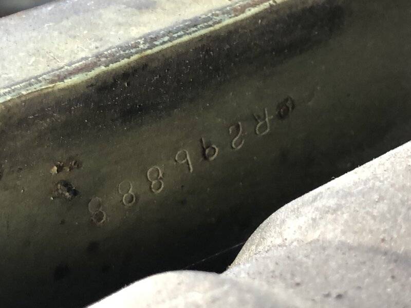

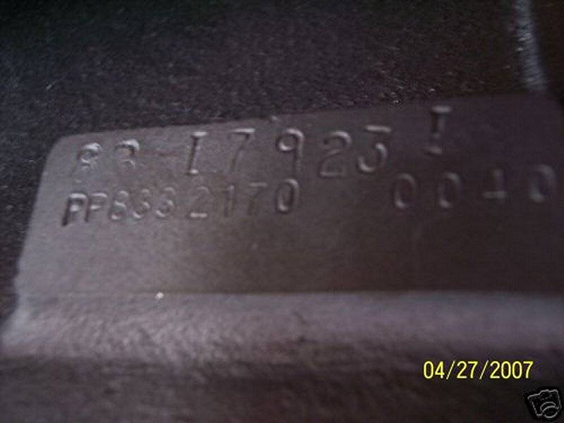

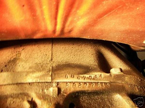

For model year 1968, there are few possibilities of a VIN stamp. The VIN is not stamped on the body like 69 and later cars.
1) The VIN plate on the dash.
2) Possibly stamped on the back of the engine near the oil sending unit.
a. An automatic transmission may have the VIN on the transmission bellhousing opposite of the engine stamping.
b. A manual transmission may have the VIN stamped oil the passenger's side of the tranny.
